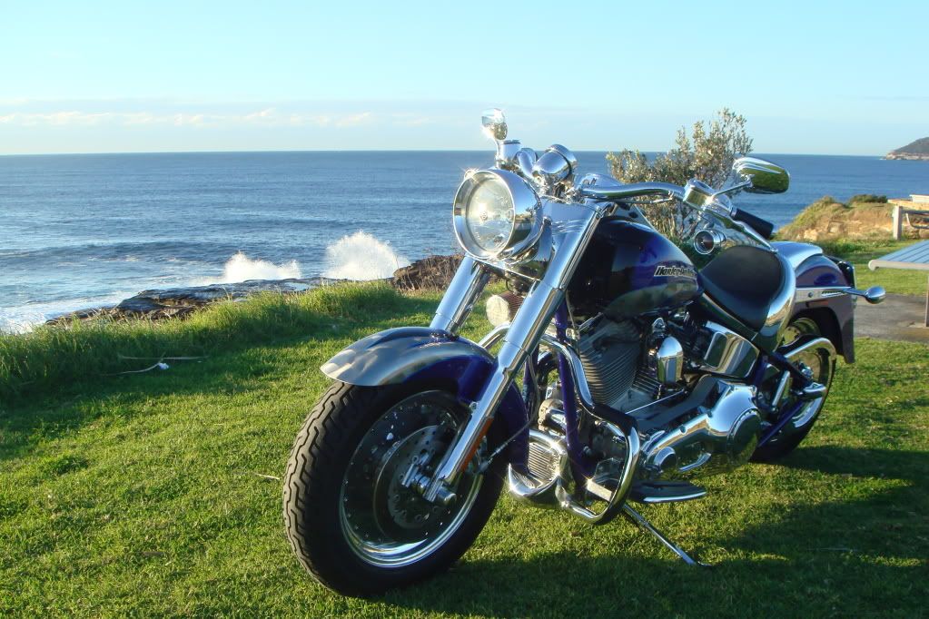

    Nice Fatty!!
    I have mine lowered a couple of inches. With the stock seat it was a killer. The Mustang is better, but it is still a hard ride, and yes, cornering you will need to get off the seat in the twisties!!
