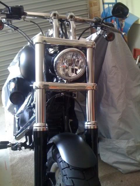

    While on the subject of headlights for the Fatbob. My Bob lost an eye and its never been better (particularly when night riding). I bought one of those bates style of fleabay and gave the wiring a go myself (no electrical idea at all). Found some wiring diagrams on the net and armed with a soldering iron and heat shrink......PRESTO! Very happy with it.
