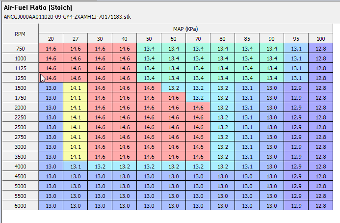

    It’s definitely an aftermarket cal, either SERT or the newer SEPST.  The cal ID is a dead giveaway:
    176AE106-001
    OK, when the Power Vision sets up your tune for Auotune Basic, it makes many changes to the actual tune while you’re in this state.  When you export your learned values   and then exit AT-Basic you would then flash a corrected tune back to the ECM.  This tune will only have 2 things changed, those being VE front and VE rear.  The whole point is to correct the VE tables so that what you command in the fuel (AFR) table is what’s actually achieved when it comes out of the tailpipe.  As you can see from your fuel table, it’s loaded with 14.6 values which is actually stoichiometric and great for “lean burn / fuel efficiency”.
    Here is what we would use for values:

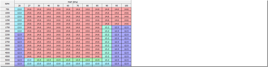

    As a matter of interest, this is what the dealer put on when I had the bike delivered,
