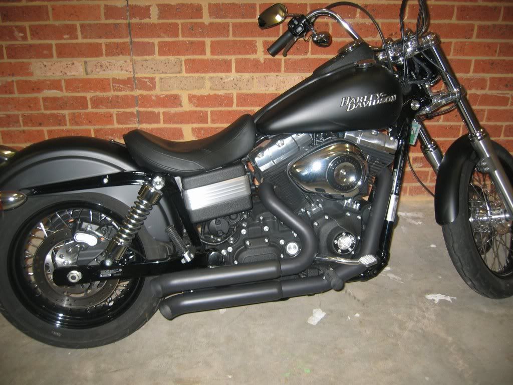

    photo for anyone interested
  • AJ56
    AJ56
    could also bee the exhaust servo motor turning..
  • AJ56
    AJ56
    could also bee the exhaust servo motor turning.. nice look on the pipes as well... What is the quality of the work Like?
  • 308bever
    308bever
    those pipes look great (((-:
    There the new Bassani Firesweeps
  • Train
    Train
    Quality of the pipes is very good. They've also got a real nice note. Just have to get used to how loud they are. A lot louder than the slip ons I had on. Getting a lot of popping on decel, but I'm installing aircleaner and TTS tomorrow, so hopefully that should take care of it. In the end, I'm very happy with these pipes
