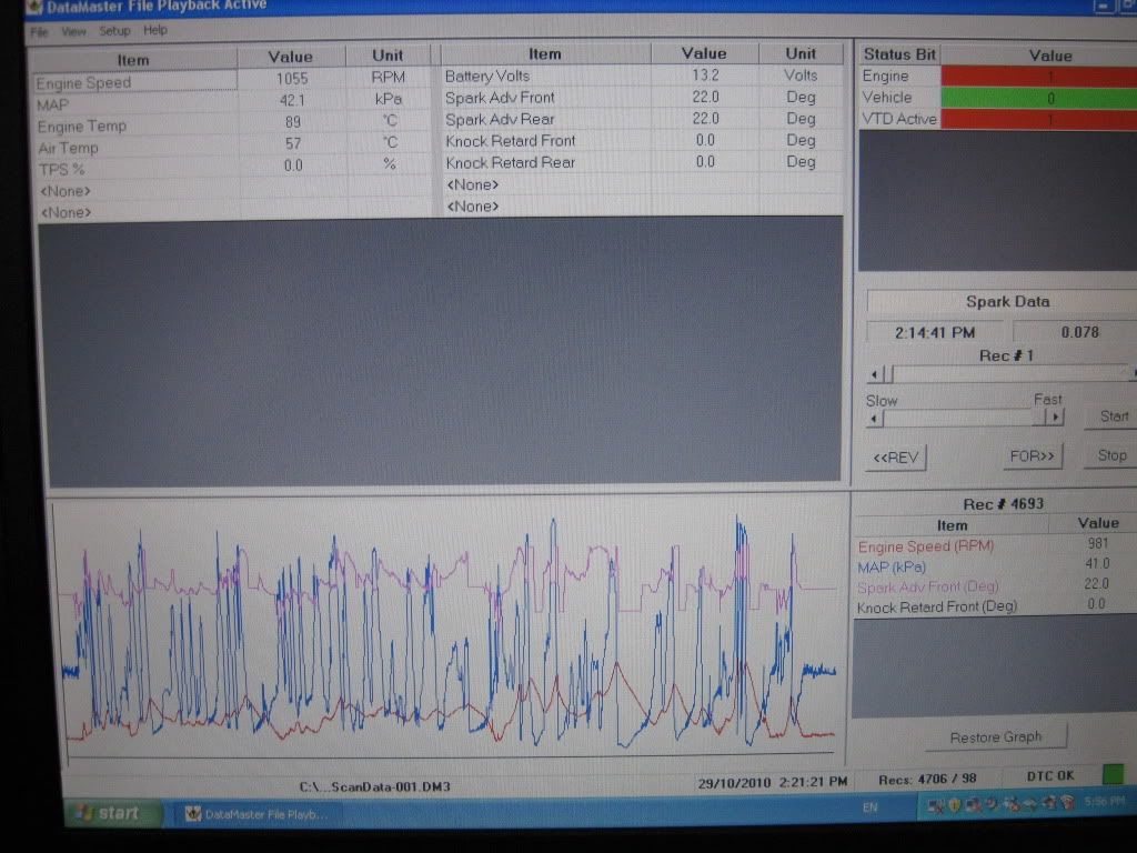

     I have just finished vtuning and I have some pinging that I am trying to eliminate.
    I do spark data datamaster runs and get no knock retard showing at all......even though I can hear it pinging! I have zeroed the "Adaptive  Knock Retard" as advised.
    Could it be that my knock sensor is not working? Anyone know how I can check?

     Best I can do...........dunno what to do with those Dm3 files to get em on here!

    Now that you have finished the fuel tuning you need to turn the knock system back on. Put the adaptive knock table back to it's original settings and go try again.

    You are suppose to return the tables to original after you have completed your fuel tuning. I will take a look at the manual and we may need to make it clearer. Remember that the data we are recording is what the ECM is telling us and nothing more. So if you do not see any retard in the recording the ECM is not detecting any.
