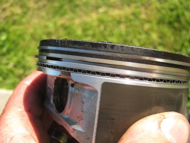

    When I bought the bike new back in March I used "Motomans" street break in method. ....link ....http://www.mototuneusa.com/break_in_secrets.htm.........so now that I have removed pistons and barrels, it is a good opportunity to inspect the results. Below is a photo of one of the pistons I pulled out today.
    There seems to be very little blow by, which of course is a good thing. I'm no expert, just a long time HD rider that likes to do as much of his own "mechanicin" as he can.
    Anybody got any opinions on the condition of my piston after 12,000kms?

     103 kit installed and rings bedded, oil and filter changed, have done 1 vtune so far, will do some more next weekend. Runs real good! pulls strong!........gotta be the best $700 I ever spent!
    I did check the ccp after install and got 190psi, but this was before any running in, I would imagine that after bedding the rings it will be higher.
    There was a lot of carbon build up on the old pistons, so you might be right Hogbag. This may have been caused by the bike running rich for a while (during tuning with TTS) and also the oil being fed back into the combustion chamber from the crankcase breather. This may explain the high ccp before pulling it down.
