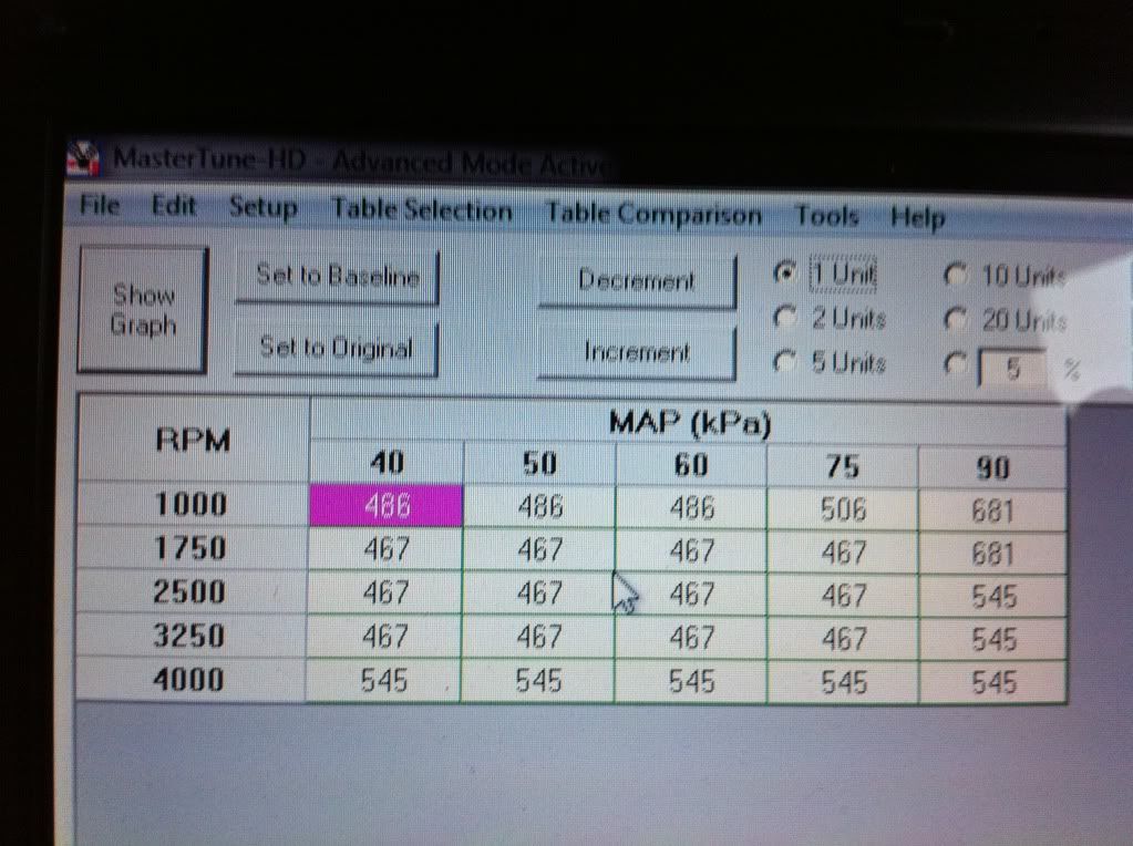

    Fellas, just want to make sure i get this right.
    Do I change every single clb cell in the attachment below to 720. Cheers

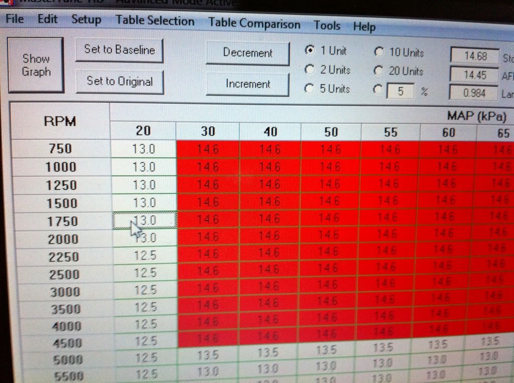

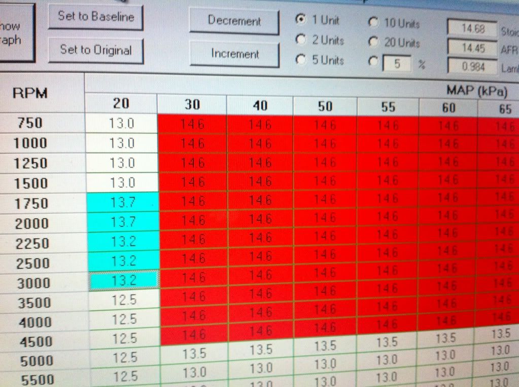

    ok, tried the AE176 today and got caught in some traffic, bike started idling strange and then just stalled. AF176 felt a lot better for me anyway. The popping is driving me fucken nuts and I haven't really got the confidence to muck around to much with the TTS.
    The manual says;
    "to richen or enlean the mixture during the entire decel event, the recommended way is to change the AFR table in the first column (20kpa between 1750 and 3000 RPM by 5 to 10 percent). Some experimentation here will find the sweet spot that elimantes popping"
    so if i want to richen it up a bit would I change the table from this
    to this
    will this richen it up a bit and get rid of the popping. Am I on the right track or should I look at doing something else.
    Thanks for your help fellas
  • BURTO
    BURTO
     Yes Train, thats it mate. Try that and if no change try another 5%. If no change then try decreasing by 5 or 10%, just incase it might be popping from too rich a mixture.
