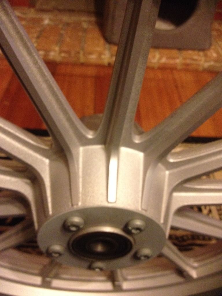

    I see John is out you way these days Brian, That makes things a little easier, I going to drop of some Sportser Wheels tonight to get done,

    The Wheels i got none came out great, better than new
    [URL=http://s258.photobucket.com/user/raced86/media/finish_zpssgajuzae.jpg.html][/URL]
    [URL=http://s258.photobucket.com/user/raced86/media/wheels_zpssu3jdsgs.jpg.html][/URL]

    they do look good,, i'll keep an eye out on the other thread you started on the build,looking forward to it,
