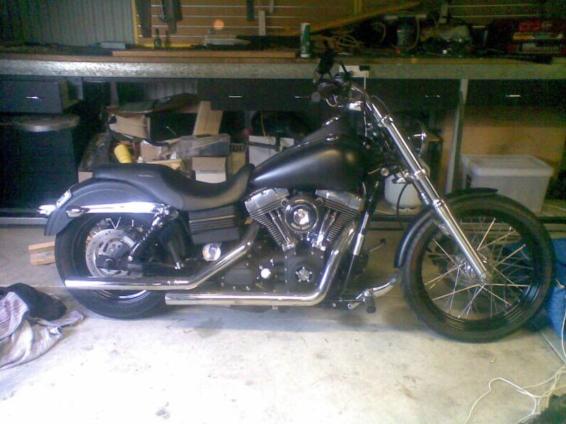

    here is a photo of mine with the 3 degree cups from vulcan
    They are a good product but I have just done something a little more permanant +6 degree

    Thanks Dingo. It will look almost identical to my bike when I throw them in. Are they 3" extended forwards?

    yeah 3" forward, I just cut out some 10mm plate and drilled the holes, got the brake rod extended

    I had them on with stock front end, no problems, thats a 21" front wheel on the front too so with a 19 you'd have even more space
