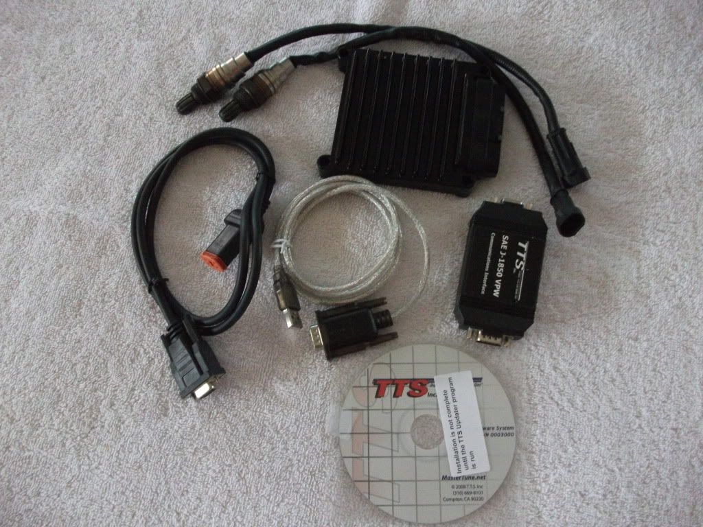

    Seein you bastards twisted my brain into buying a TTS  here is my 1st question - are these all the parts I need to do the swap over or is something missing - as a shop done the original job of installing the thundermax?????
    2nd question I paid $470 delivered to my door from the U.S. is that about the going rate???

    Looks good to me the rear O2 sensor goes under the oil tank and the front one is in the plastic box between the front of the frame all the gear is there though you wont have much trouble with the tts and it has  lots more options to use even a idiot like me managed to tune my bike in three runs.
    P.S> HINT - just bite the USB to crimp it a bit so it does fall out on your tuning runs.
