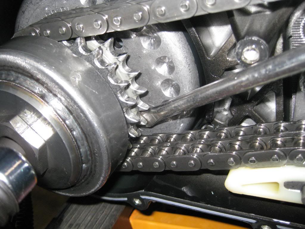

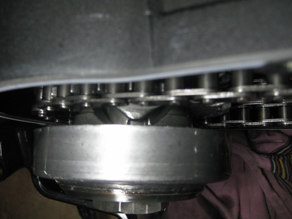

    Hi 2001 fatty, pulled the primary to check out whirring noise, If i put a screwdriver beteen the case and the sprocket and lever( not too hard) i get about an eight or so spring/travel outwards. Does this seem normal? also looking down at the compensator it shows a fair gap between the jaws,  i know they slide so that might be normal i have linked a couple of pics thatm ight assist what i am trying to describe. Dont really want to pull it off unless i need to  Cheers

    I cannot say as to whether the compensator nut is loose or not.
    But I can tell you that being able to pry the sprocket sideways does not mean it is.
    All you are doing is compressing the spring pack.
    As for the gap, it is the tips of the outer drive unit the need to make contact in the valleys of the sprocket, not the other way around.
    If they were not in contact, the inner sprocket would have "sideways freeplay", and not need any pressure to move it.
    A whirring noise is likely to be.......
    Chain too tight.
    Crank out of true(much more likely on later models).
    Cam bearings or tensioners on other side.
    To check the comp nut while you are there would make sense, as it can be an issue (well known, but not so much with your early type).
  • rockyrob
    rockyrob
    Thanks for that,  I checked it anyway, it was fine, slacked chain back a bit till it actually was hitting cover occasionly and the whirring was still apparent. Cam shoes are fine. Noise seems loudest at the front just  behind rear guard (standing still) so i figure t is echoing off the tank and guard. almost talked myself into doing the hydrolic cam tensiosner upgrade and new bearings to see if it helps, either that or get used to  the noise
