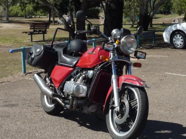

  • Deadly
    Deadly
    Different sort of idea, but that don't make it wrong
    In my 1982 GoldWing I use Castrol Active 20W50, This is a good product and correct for this bike except that the starter clutch sticks on hot starts which means I should be using the 10W40 recomended by owners manual, and despite my wanting to use a heavier grade oil because it's a 147,000 klm old motor fact is the maker new what was right and lets face it, it has lasted 28 years.

  • Deadly
    Deadly
    At the risk of going way far away off topic which is generally considered UNCOOL
    is there any chance Dicko your checking to see if I am on a Wing forum?
  • Deadly
    Deadly
    and I just posted a Honda pic on a Harley forum:)
    posted lots of Harley pics on a GoldWing forum but I just can't wait to see how this one goes :)
