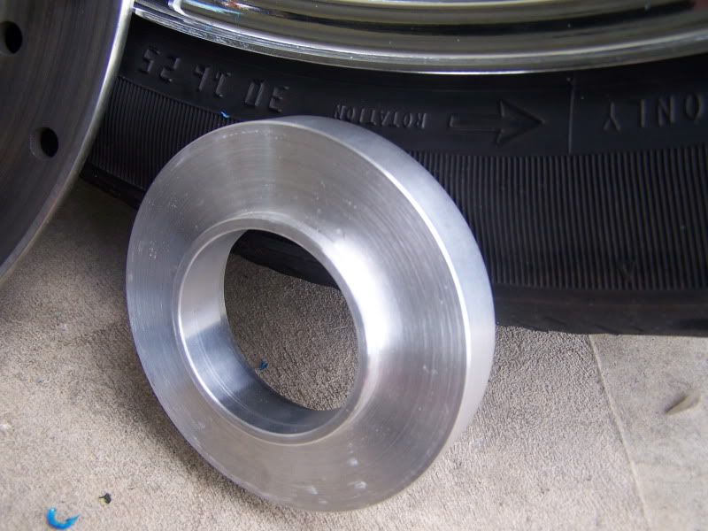

    Made up the needed spacers the other day at work and ripped down the front end today.

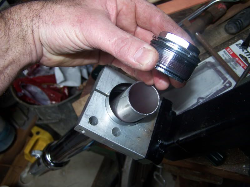

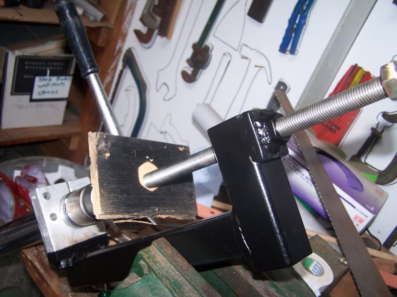

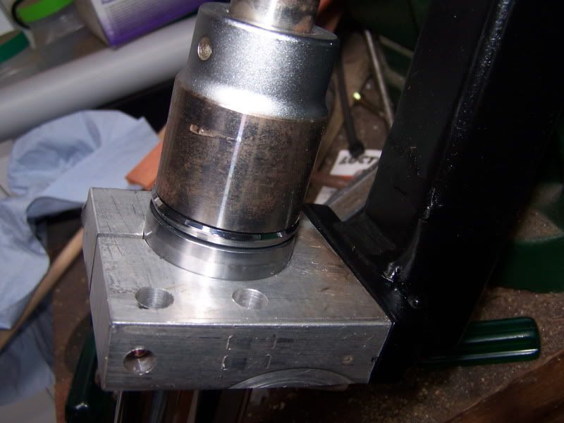

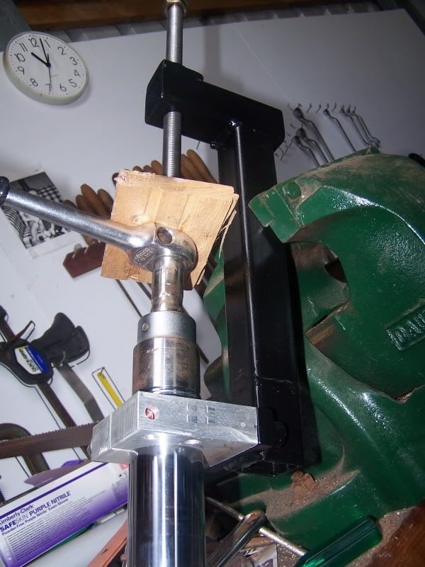

    Also made a spring compressor as last time, when I fitted my race tech springs, I had a hell of a time refitting the caps. I never changed the fork oil last time either as I didn't take the forks right out of the bike so will do that now as they are certainly off the bike now!! heres some pics so far.....
    bike on stands I made

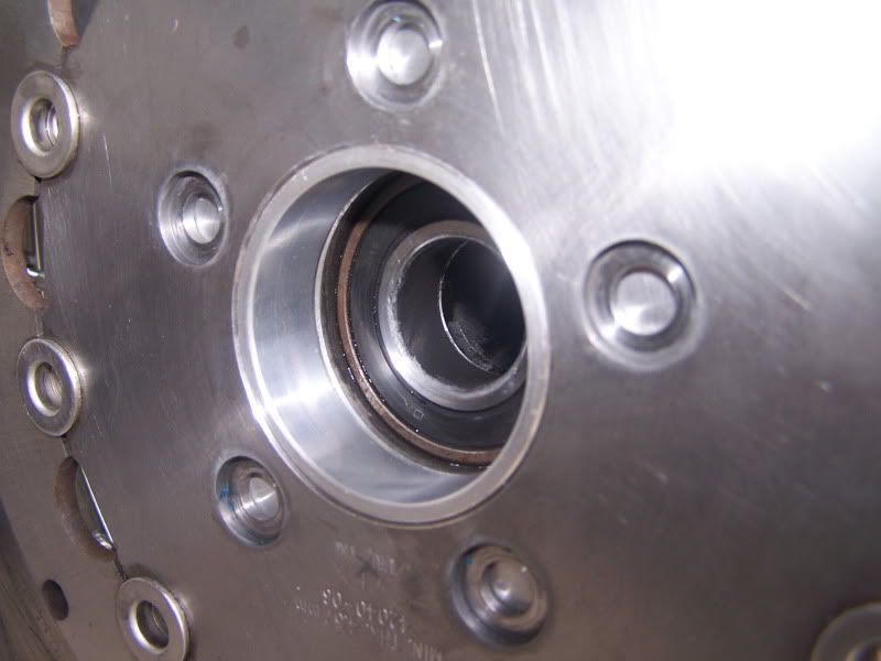

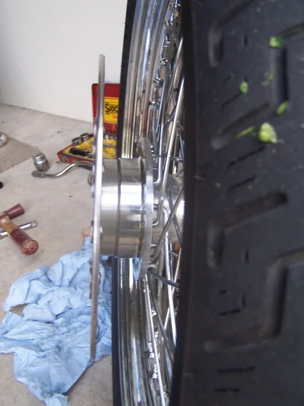

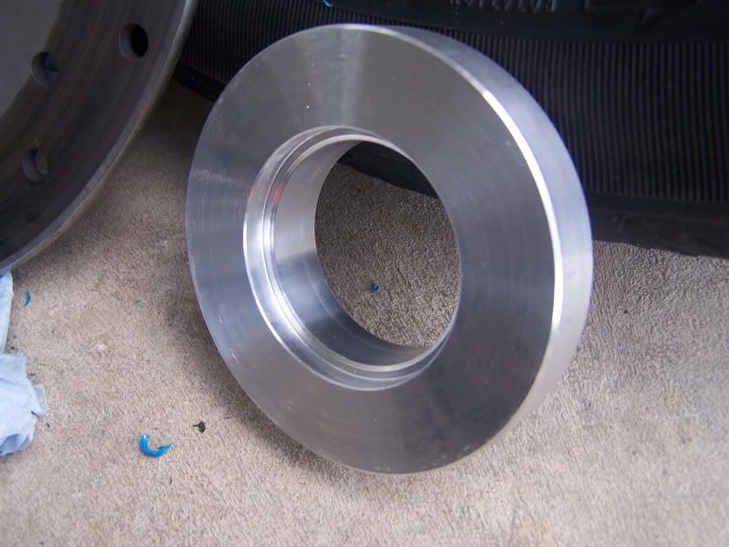

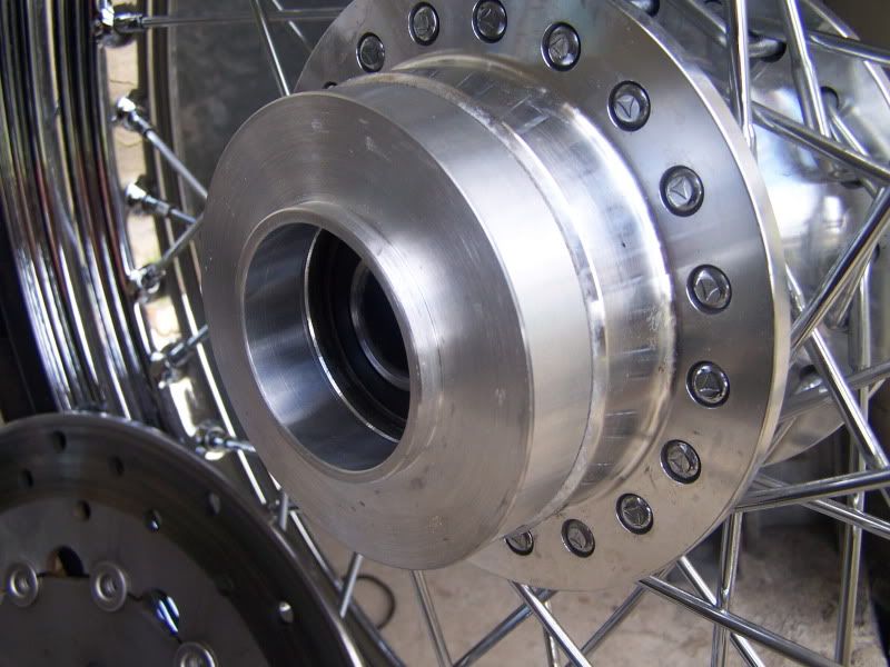

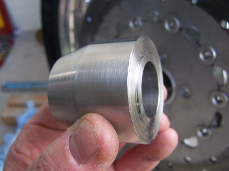

    a few shots of the T6 Alloy spacer I made to keep the rotor lined up with caliper, I just have to drill the through hole for mounting bolts....

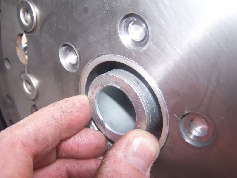

    old axle / wheel spacer

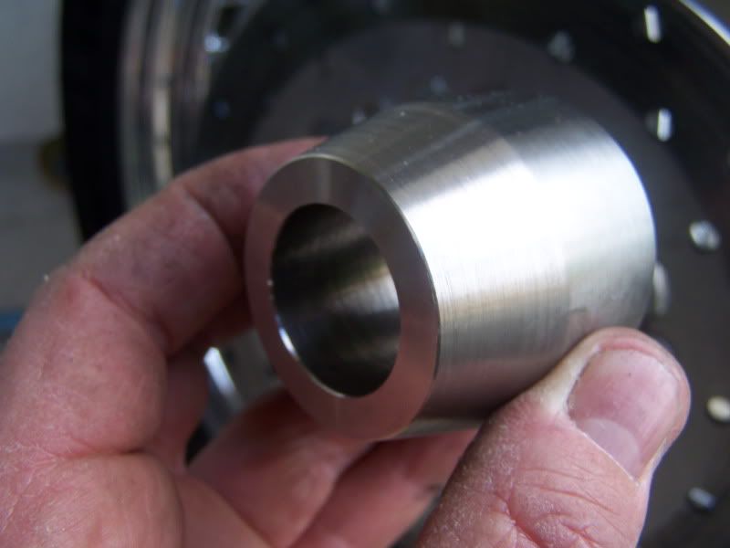

    new stainless steel tapered spacer I knocked up
    Spring compressor

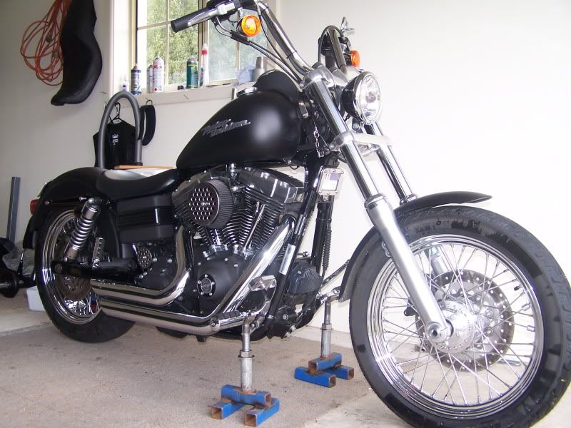

    fitted new trees and whacked the forks back in tonight, lookin' good.............

    nice job so far - awesome idea for the stands , hold the bike fairly sturdy?
  • Daggs
    Daggs
    very sturdy...
    to lift the rear I just put my floor jack under the rear frame, just in front of the swingarm.
    depending on what Im doing then I can put my car axle stands under the swingarm.
    Solid as a rock. There is obviously some rubber strip in the piece that goes under the forward controls so the chrome doesn't get marked.

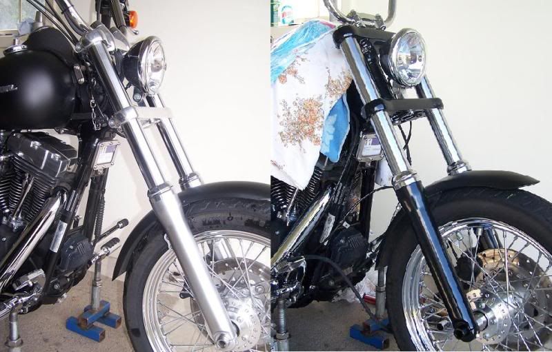

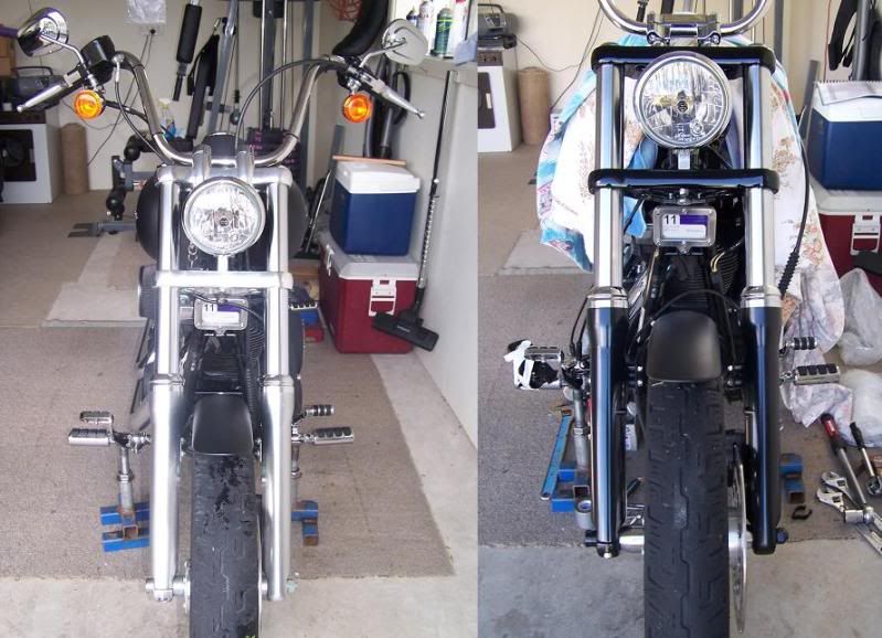

    heres a couple of side by side shots, can't finish off yet, still waiting for my bars.....
    Front on...
    side on

    hi daggs great work mate , just out of interest how wide was ur rotor spacer
    skid
  • Daggs
    Daggs
    I'm working away at the moment, will let you know when I get home Skid
  • kickinon
    kickinon
    Daggs,,Very nice mods.!! What front axle is that?
    or did you run one up yourself?
  • Daggs
    Daggs
    Bought the black fat bob trees and axle from m&m in the states and machined all the spacers myself
