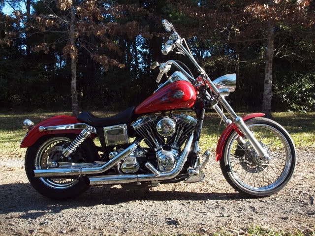

    OK, guys, need some opinions.................
    Here's the beast as she looks now..........
    Now...... I'm seriously thinking that a Fatboy front end might be the next mod.  I have a suspicion that it would look really cool (not to mention different !)
    2 questions..........
    1.  waddaya think ?
    2.  how badly am I gonna f*** up the geometry ?  Anyone know what I'd need to do to correct it ?
    dc

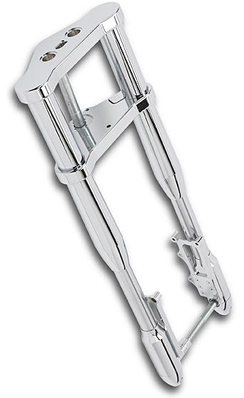

    I Stock  58 mm Inverted Front Ends. I have Sold lots to guys that are Fitting them on to Dyna's, Stock Length Dyna Front Ends a 23" Long, the 58 is 24" and go up in 2" jumps, I have them in 0 or 5 deg . They are Wideglide Spec and use a Pre 99 Front Brake. You also need to use a Internal Fork Stop Kit, Front Ends are on Special this month $1000.00 Fork Stop Kit $95.00

    No Black Dazza. There Mid West, If your need a Black one, HD have them for around the $2500 mark
    They will fit up to a Dyna, All you need to do is use a Zodiac Z0944248 Hidden Fork Stop Kit,I sell them all the time to guys that what to fit Softail Front Ends to Sportsters and Dyna's
