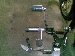

    One of the best things I put on. The only drama was that it puts your feet out about 1 1/2 inches wider and a long way from the rear brake pedal and the shifter. luckily I have the genuine extended reach controls, where the actual peg mount is able to be removed. I had some new shorter ones machined up to put the pegs back in the right place.
    Once you set the stirrups to your liking, they are the best on both long and short trips.

  • Shawry
    Shawry
    Here is my forward controls with stirrups fitted. The difference is I machined up new mounts that were shorter because the stirrups push the pegs out to wide in my opinion.
