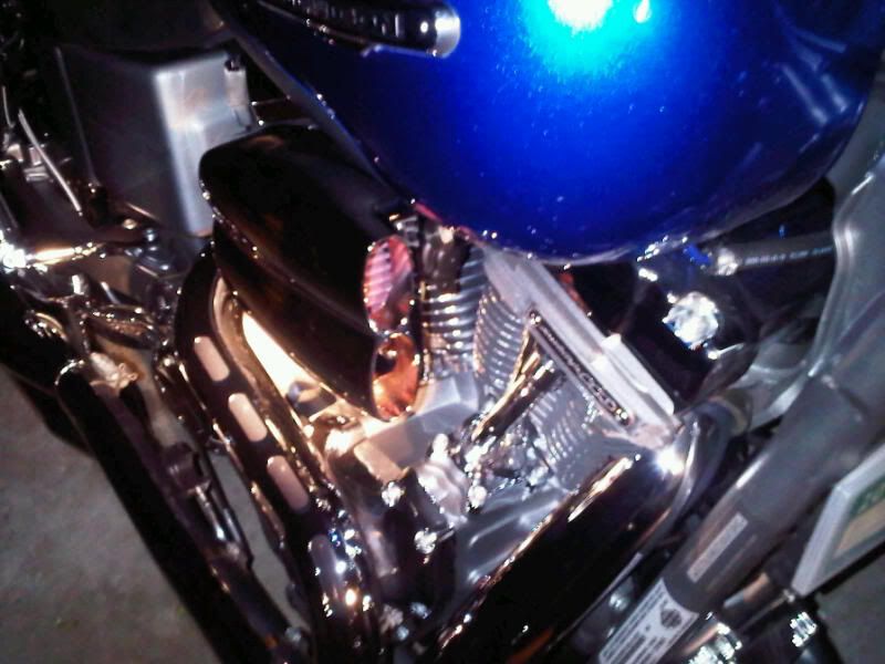

    So lads, hit about 700klms now.
    Only things is, the bike is kind of "breaking itself in"... last night battling back from Wisemans the entire air assembly just fell off! WTF!?
    AH WELL made it easier to install the MoFlow kit when i got home last night. HAHA.
