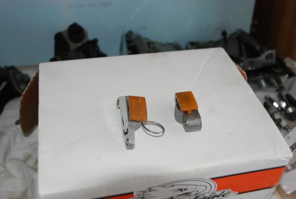

    There are a few observations in the stripdown, first being the minimal wear of the cam tensioner shoes, hardly a mark on them after 57000km....I wonder if Amsoil had anything to do with it??....

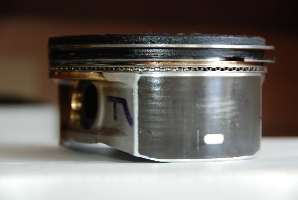

    The next is the carbon buildup on the pistons....my bike used absolutely no oil....I can only put that down to the breathers venting oil vapour into the intake...

    The pistons look like there was blow by from badly seated compression rings ? Did you run the bike in yourself ?
    One reason I decided to rebore used cylinders for my rebuild, is from hearing stock Harley Cylinders are known for inconsistent / poor clearances.

    After reading ya comment Speedzter, and looking at the pic closely it seems that the second compression ring is not sealing properly.....Ye I ran it in from new, with the advice from the dealer, quote:
    ride it like ya stole it!!
    Gonna run the build in differently....nice and easy, per the manual

    Update on my pots.....I rung Galloways today and David tells me that the bores are pretty good, just needed a bit of honing....With torque plates they are out about 1 thou, which is well within limits....
    And the old rings....Had a good look at them today and the second comp ring looks as if it has tilted hence the wear on the bottom 1/2 mm....both front and back display the same wear patern...
    I don't think it would have helped compression.....Maybe someone out there can throw some light on this....
