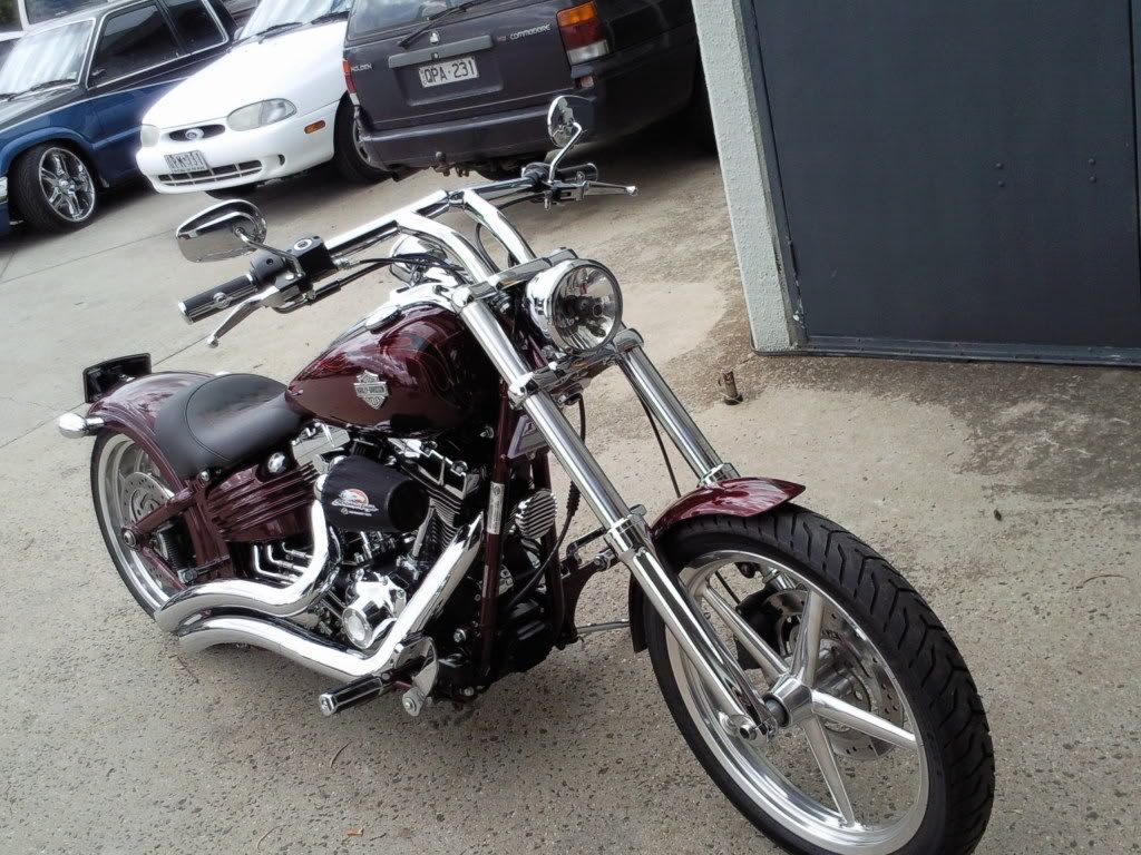

    Got the Slammers on my 2009 Roady Classic. They're comfortable as, look good and get some good comments. You'll have too get yourself a cowelling to suit and rewire your electrics with FBW. existing wiring and brake lines just fit but no problem. Be careful running the FBW and other wiring, there could be some sharp edges inside the bars thet may peel back the insulation.
    You'll find them great on long runs, Im 6ft and have no problems.
    How about this style ? 1-1/2 , 6" Rise, 3" Pull Back.
