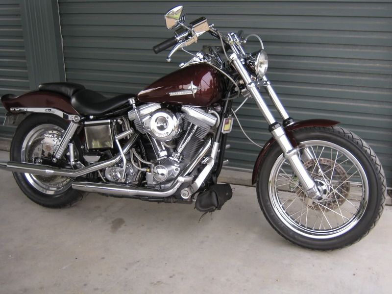

    Cromag, mate got his conversion kit thru Rollies Speed Shop. Around $400 from memory. Give Dean a ring at Rollies, he knows his stuff! He will let you know everything you need and they deliver quick.
    Kiwidave is right, properly aligned and tensioned, etc. but what fucks most belts is rocks going thru them. Rock holes in the middle of belts can last for ages but get a rock thru the edge and it will tear thru the rest of the belt in no time. The most common culprits, the loose metal when they reseal roads! As ugly as they are, belt guards are very necessary!!
    And yes, no need to change until you have to.......might as well get all the use out of it!
    With the chain you can run a 150 tyre, may need to watch guard strut bolts. The 150 fills the rear guard out nice!
    Have a look!

    Sexy bike Burto....this could easily become a I heart my wideglide thread.....; ) Thanks for the info, that'll be priceless and gives me somewhere to start. I must be down for the first shout id say..
    I really dig the shocks on your bike, it looks like it'd handle....mine looks great low, but scrapes, What length are those...and a 19" front wheel? some great mods there Mate....certainly looks the buisness too

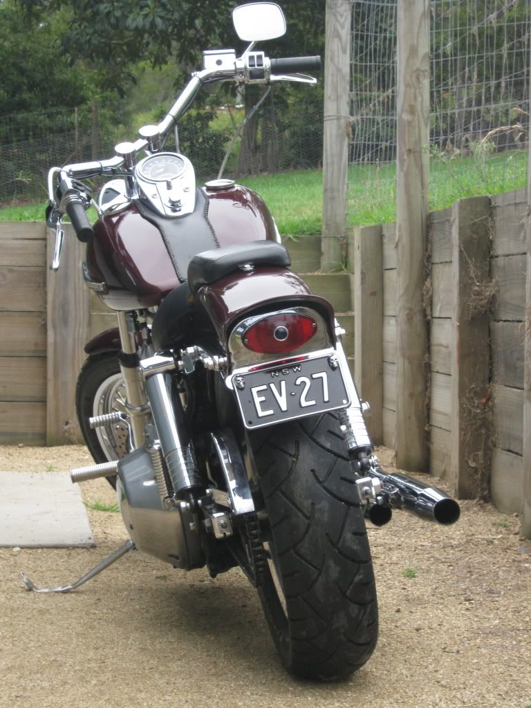

    Tidy!......gonna have to tart mine up, I dont wanna let the standards fall. Angry1 your bike looks like it gets a fair bit of lean too, yet youve got stock shocks (?) is there a bit of stretch in the forks? the 16" is bitchin as well.....hows she go through the corners?

     Thanks Cromag,
    shocks are Fournales Magnums, 12.5'' from memory. 19" front wheel and progressive springs makes this bike handle pretty F*ckin good!
    Angry, nice bike mate, a 16" would be my 2nd choice. Gotta love them '61 Pan "gunsight" badges!
