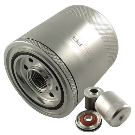

    I have a special on right now for all the HD Forum Guys. PFE Reusable Oil Filter Kits for Harleys $140.00,

    looking at the photo, is the actual fiter a washable-reusable  type?,
    or is that part  to be replaced each oil change?
    looks like a paper type cartridge???
    is there a write up on these units some where??
    They have a washable Stainless Steel mesh Fitler

    bucket, thats 14 oil changes, but where do you get black ones to suit an 88ci twin cam at $10?? l think im paying $14-$15 at the harley shop,, ALSO
    after checking these type of filters out on the net im thinking $140 is a good price,,
    ive got some questions about them before l commit..
    is a replacement ss filter available if neded & how much? does it meet Hd specs of check valve? bi-pass valve?
    (l dont know what they are but was asked to enquire for someone else who's interested...)
    if your going to keep your bike for a long time ,run it through rivers, dust, un forseen stuff then these make sense,
    l dont know if its a messy proceedure cleaning out the part?or how you get it real clean since its got to be very fine mesh,
    , couldnt be as simple as swaping over a disposable one,,could it? im keen....

    I run a stainless mesh filter on my KTM 950, but mainly because they can have a water pump seal issue that can collapse a standard paper filter. That and the stock filters are $35.  I'm not totally convinced they are the best filter otherwise. You really need an ultrasonic bath to clean them correctly, and it's still a hassle. Throw away filters are much easier.
    I'm using K&N filters (with the welded nut on the end) on the Harley.

    I have one of those from walka (pro flow)
    And i like it because like oz said ya can see if there is any bits in it
    They use them on race bikes
    The only thing i changed was the o ring to a viton one more heat resistance
