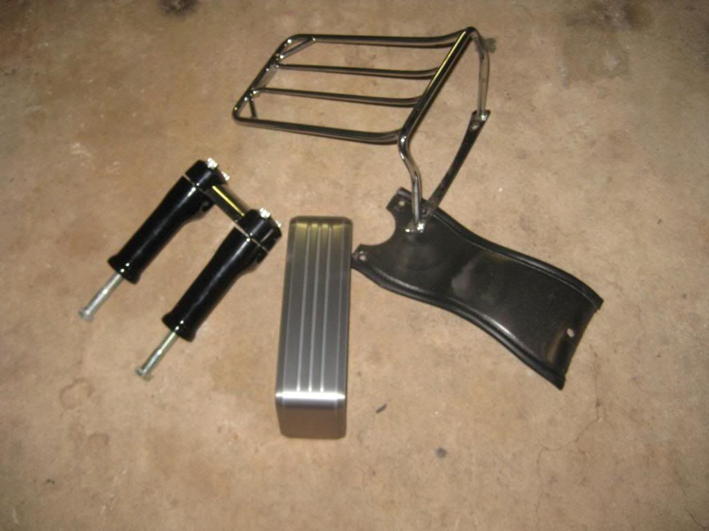

  • rockyrob
    rockyrob
    2009 Fatbob here, My first Harley so cant  compare with any others but found my back playing up after half hour riding.Reckon its more to do with the drag bars and foward controls. I fitted 6 inch risers which move bars back an inch or so and got some mid mount pegs from the spares box at the dealers for nicks. Just flip them down when on the highway and feet and body are more alinged and back issue is not an issue so to speak. mid mounts are basically unnoticible when up with standard pegs and rubbers as they blend into the engine colour,
