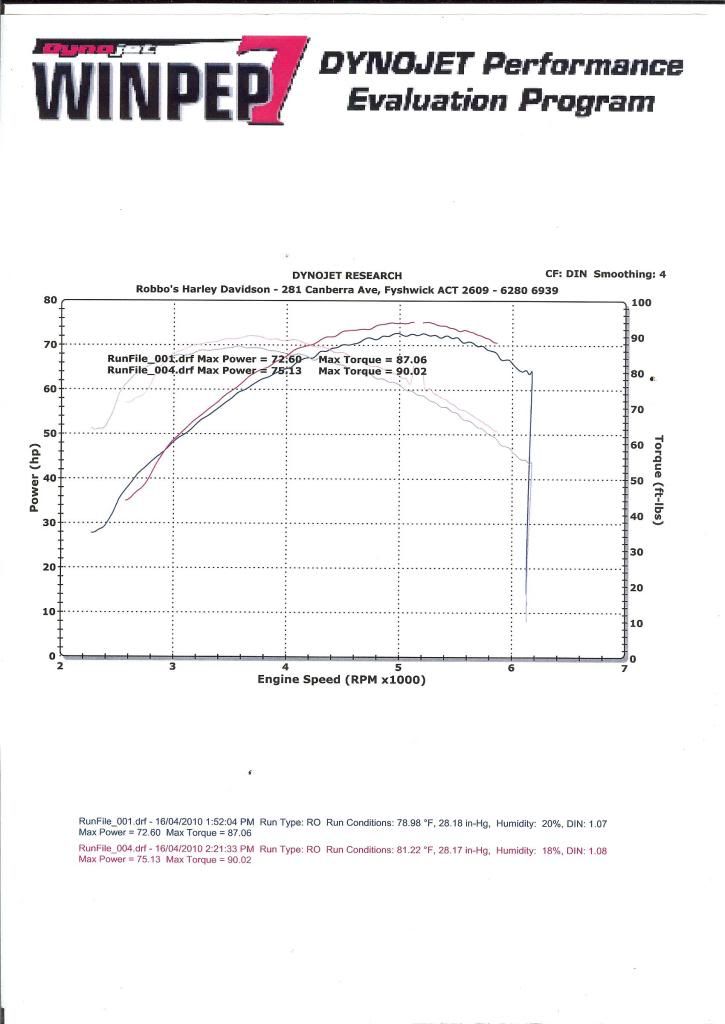

    I had to get my 8000klm service done, so I went to robbos in Canberra, I had a good talk with the head Mechanic Peter, in the end he gave me a good price to get a the service a S/E hi flow air filter, and a pro tuner, I was sick of waiting around - I was going to get a Fuelshot, a Thunder Max Auto ???
    My bike goes heaps better now it can breath, this is the Dyno is asked for, anybody know if this is any good??
