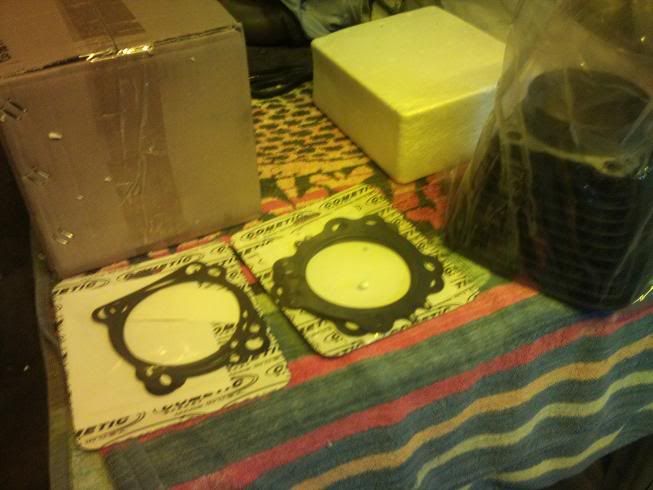

    Finally got my NRHS 1250 Conversion kit today, with prefit all done by NRHS. Sorry for the crappy pics.
    Now I've just got to get it fitted!
  • grafpak
    grafpak
    looks good...!!

    Bike shop here in Mildura will fit it up & clean up the stock 883 heads for me. - Should get done some time next week.

    HMMMMMMMMMMMMMM big jugs, nice

    Whole thing cost me less than $900aud here.
    Prefit is exactly that, prefit / gap rings to pistons & prefit to bores.

    All done....  Fitted the kit & all went well but some of the lower barrel fins needed linishing to fit though.. - Ended up leaving the heads stock for the time being, may end up with some 1200 heads down the track.
    The difference all ready is like chalk & cheese! - Its got some shove!
    Will run it in & around for a 1000km or so & build on the tune & After that I might even pop it on the dyno to see what it makes.

    On a downside, found something alarming also on inspection of the old pistons. - Considerable carbon build up, after only 4600kms. - Mind you, they have been very, very hard Kms. - I think this issue stems from they SE heavy breather's internal / breather system. - I might look at modifying the heavy breather for external breathers.

    The carbon build up is probably the breather system not coping to well at continuos high revs but something to think about is ring leakage , the Factory assembly is only running about 40% as acceptable ( Resulting in Higher running temp at high speeds , Lose of available power ,Eccesive " Blow By " and carbon buildup around the ring and land area . ) Piston to bore clearance / Bore Roundness / Ring gap are All contributive factors youre " engine builder Builder has to play with .
    As fore bolt on stuff out of the box you still have no youre stuff to get the full effect
    Now if I were contemplating 883/1200 conversion I,d start with a set of Keith Black same weight pistons and find someone who will bore youre barrels so they are not square , some lage dia black diamond valves a reseat and some gaskets a little bit more duration and or lift in the cam dept ( Not too much or you will alter youre valve geometry and thats a longer story
    If you get what you have right you would be surprised how well it goes -----That is for a Dinosaur :o)
  • nhb006
    nhb006
    The '10 Iron uses different barrels with thinner liners to previous 883's. - Issue is, not enough material to bore to 1250. - So I've been told. :)
    NRHS kit is Axtell / NRHS barrells, CP forged pistons, Total seal rings & Cometic gaskets.
    Got to http://www.nrhsperformance.com They know their stuff and Dan is great to deal with.
    Walka's product is spot on, Infact I have an air filter kit here he was generous enough to supply me with that I've been saving for a rainy day / another project.
    Correct-o-mondo about the breather system. - I'm going to have a go at converting the SE heavy Breather to external venting breathers in the comming weeks.
