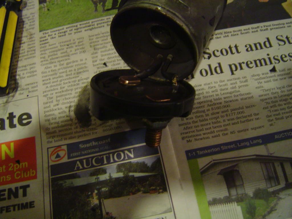

    Pulled the solenoid off again and noticed that the wire that goes to the relay contact has two wires, one is no longer connected. (see photo, wire on right) Is this the weak point. Please say yes. Then how do I fix? Auto elec job? The rest of the solenoid appears to be sealed unit

    Okay Burnzi,even though I can't make it out in the picture,it sounds like you have located the problem,unless you have a soldering iron to reattach the disconnected wire,it looks like it is time to take it to the Auto electrician,should only cost a couple of bucks to solder wire back on,and get him to test the solenoid,before you put it back on the bike.

    Thanx mate thats what i was thinking I have a soldering iron but im not confident that i can fix it well enough will get the cook to drop it off at the auto elec tomorrow thanx for your help

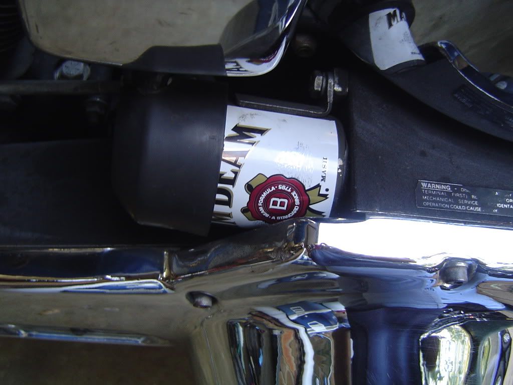

    Yeeha problem solved or I should say soldered, it was one of the wires running to the small terminal had cracked. I should have painted it before i put it back on but was too impatient to wait for the paint to dry, so i improvised looks heaps better.
