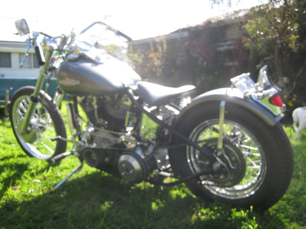

    I took a ride with Finny out to Kickinon's today...   Yep I'm impressed mate..   the bike's are coming along nicely..
    sorry about the quality of the pics... only had me phone..

    Wozza was like a kid in a candy store..........
    But they do look pretty good
  • Hound_Dog
    Hound_Dog
    Very nice mate, excellent project

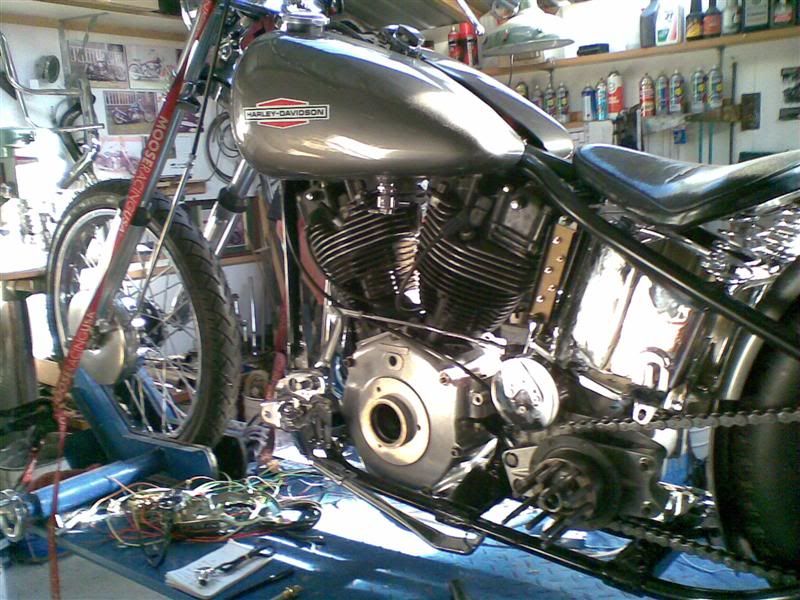

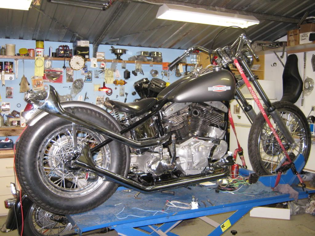

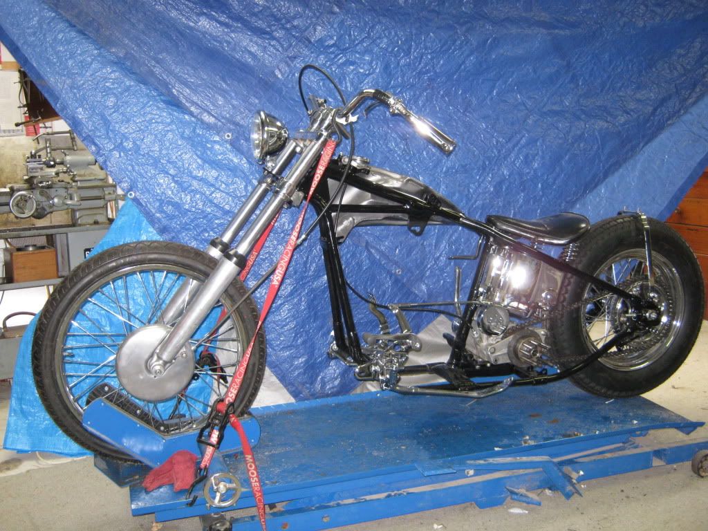

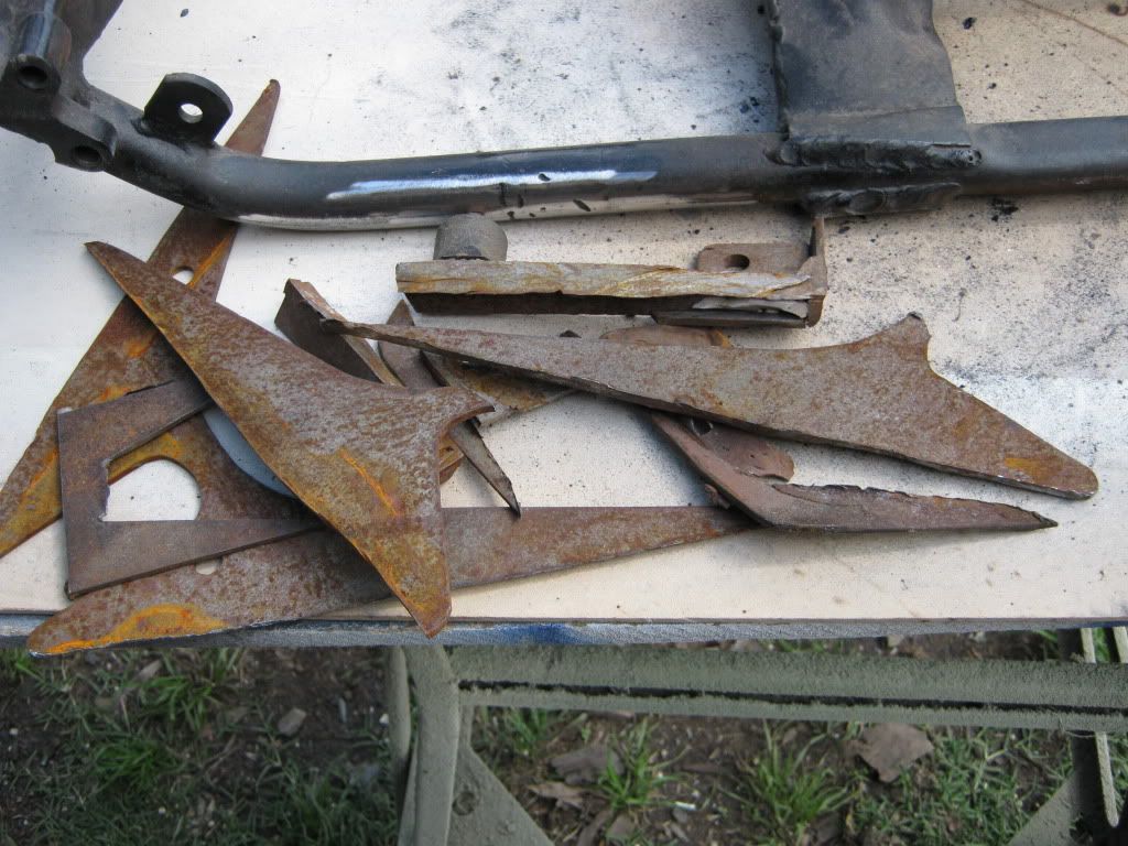

    looks prety much the same in this photo as the last , but its all bolted down tight now,

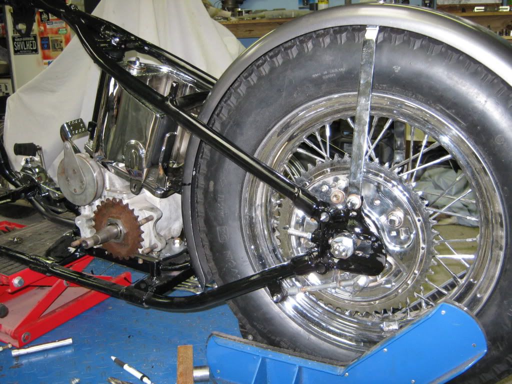

    made up a ss braided rear brake line with brake T out of some Russel lines, since l couldnt find one (ready to go)
    im happy with it ,looks good, got good pedal & brake light , also completed the wiring loom all soldered,crimped,shink wrapped, all the stuffs working,
    hi/lo lights,, brake/tail,light,gen,light,oil light,,speedo light, horn,,( no starter or flashes on this ) mounted the mouse trap but need the cable & rod, next week for those,
    so shes ready for the motor!!! im not going to fit till ive worked out what to do about rego...

    Lovely clean lines M8,
  • Evo
    Evo
    Choice mate, very choice. Points cover is subtle, suits the look.

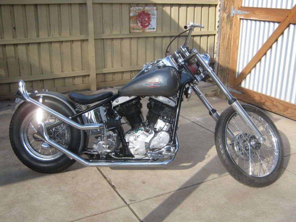

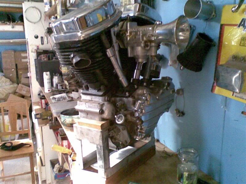

    The engine cases were made here in melbourne,they are very usable, robust extra thick in places, perfect for a generator stroker motor,
    a number of them were made for that reason before the chap passed away, not many but some were made, This set is on loan from a mate who new him well
    & wont part with them,
    ive asked him a few times & will no dought ask again, id love to keep them,
    The cam chest cover is 1 of 3 l have, a mate in the states cast them up some years back & sent me a few, they can be used on any (48-69) big twin if you
    drill the oil galeries & bush them, ive run 1 for 4 years ,1 is hanging on the wall, the other is shown on the cases here .
    Theres a joe hunt fitted, showing in the pictures
    but ill be using a dizzy,

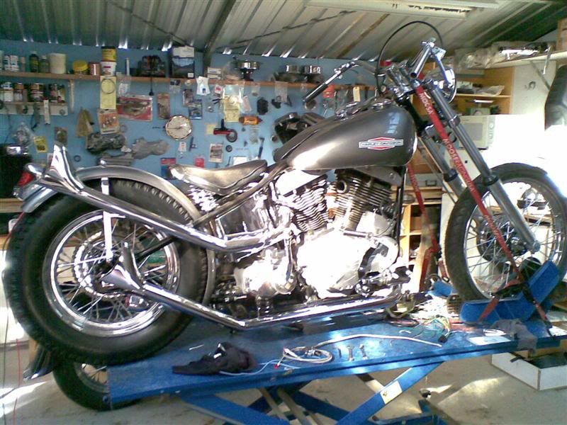

    she's on the lift at the moment, waiting on a set of softer 40lb. clutch springs, put a set of heavy duties in it but its to heavy on the hand, their 60lb. also fitting a 3inch belt cover, & removed the velocity stack cause its in the way when braking, made a new aircleaner assembly.. & need a softer brake spring for the rear pedal, once its off the lift & out side ill post a couple of photo's..
    oh one other thing l bought a gell battery, its very small to fit in the horse shoe tank, its sealed,no overflow, runs on its side, ,upside down , any way you want, never seen one before, their for dirt bikes,scramblers, etc. but if your cramped for battery space what a great jigga...

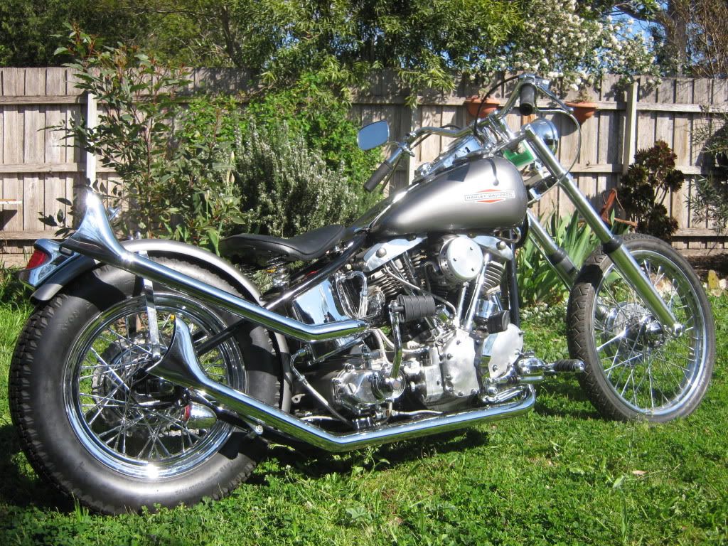

    o.k. ive finished , just fitted a set of standard clutch springs , put a little fuel in starts 3rd kick,
    l think ive done all the nuts & bolts up? find out tomorrow!!
    im going to put a small bag of spanners/etc together , head out in the morning, how long l go for depends on how the bike goes,
    & weather, planing about 3 hours, its about 8 miles to the foot hills ill pull up & check it over then, if all's well ill keep going,
    theres some great roads between here & lal lal, & a tucked away booza for lunch..looking forward to it,,
    kind of like an adventure when you dont know if your going to make it or not!!
