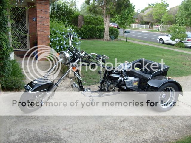

    My wife and I had been talking about building a shovel trike for about a year. You don’t see many shovels on the road anymore. Last August, my wife found an ’82 FLH 80 Heritage trike at a Pawnbrokers store.
    Photo0131.jpg Love at first sight. picture by Loosenuts-photos
    It was out of rego, had been sitting for 6 years and needed some work. I knew it probably needed its electrical system tidied up. The tanks needed paint. The clutch was hard to pull in. The chain was very tight, but if it wasn’t tight, it would rub on the swing arm because it had no chain guides. There was a box full of oily newspaper under the gearbox, so the chain being tight had done some damage.
    Anyway, I couldn’t build a trike this nice for the 30K he was asking for it, and it was by far the best looking trike we’d seen. It was a shovel too, so we arranged for the owner to take it to his place and get it going so we could take it for a test ride. My wife and I were H.D. virgins, and I had no idea what we were getting ourselves into…..Double Shovel Trouble!

    Nowadays, me and Nutts go together like Pigs and Poo. Here’s some more photos.
    S6300105.jpg Nuts picture by Loosenuts-photos
    S6300118.jpg Nuts picture by Loosenuts-photos
    S6300116.jpg Nuts picture by Loosenuts-photos
    S6300113.jpg Nuts picture by Loosenuts-photos
    That’s it. It’s been one hell of a rough ride…..
                 Thanks,
                              Rick.

  • Loose Nuts
    Loose Nuts
    Thanks so much for the encouragement guys.
    Obiwan, thanks for the compliment. Your right about me being naive about shovels. All I knew is they're trouble, high maintenance and I love them. Just like woman I suppose. But a shovel's made of nuts and bolts, so it's less trouble in the long run.
    Lucky I've been around nuts and bolts long enough to dig myself out of shit with a shovel. But woman, that's another story!
    Hmmm..........Titts or tyres = trouble......for sure.
