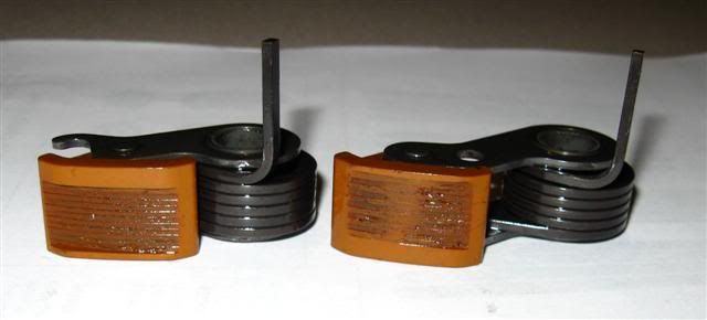

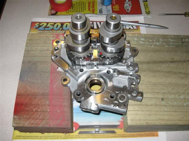

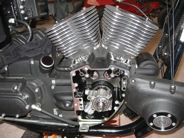

    Great weather for engine building here in Ballarat, so while waiting for the Heads and Cylinders to come back from Paul Hallam, I thought I'd pull the bike down, fit the Cams, and replace the inner cam bearings. The inner Cam bearings were very easy to remove and replace  using the correct George's tools.
    To my surprise, once I removed the bearing retainer from the cam plate, the cams with bearings basically fell out without using a press (or oven as I had planned !) There was evidence of the ball bearings spinning in the cam plate, as the bearing retainer had a nice circular groove cut in it !
    I pressed the new ball bearing on the front cam after heating the bearing on the electric hotplate, fitted a new rear tensioner then placed the cam plate in the oven . After removing the hot Cam plate, I then fitted the new rear cam roller bearing using Loctite 243, then fitted the cams with chain into the plate, along with Loctite for the front ball bearing.
     The outer cam tensioner showed minmal wear, and the inner just a little more. Would have been good for another 30,000 K's !
    There was also some interesting polished wear marks in the cylinders at the head studs and the drain holes. I'm guessing the cylinders were not correctly bored from the factory ??  The engine had done 30,000 kms, and looked good apart from this.
    Now just waiting on the Heads and Cylinders !

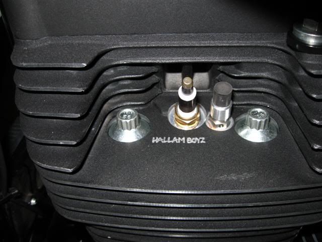

    Spoke to Paul Hallam this morning. The ported heads came out 86 cc's, and the SE pistons are 8 cc's.
    Puts me bang on where I want to be at 10.2:1 stattic with .030 HG, assuming zero deck.

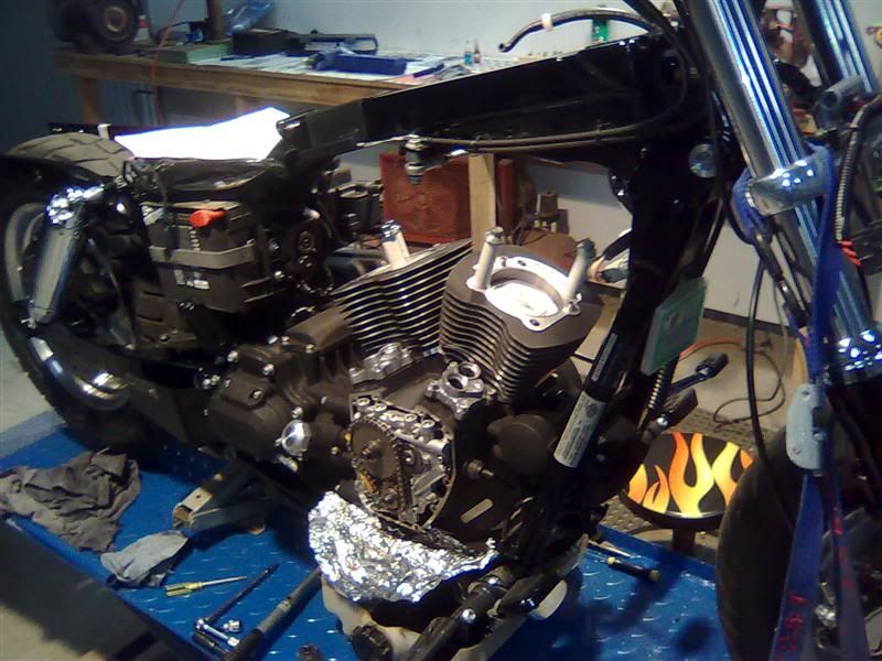

    Got the parts from Paul Friday night, I must say I have a lot of respect for how thorough that guy is in his work.
    The difference between the old 2000 heads and the ported 2009 heads is amazing.
    Finally got my bike fired up in anger tonight, and have done a few heat cycles.
    Fuck, does this thing sound crisp !   To busy working to take any more build photo's damn it !!
