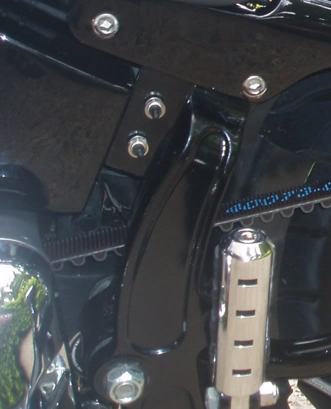

  • fatasspaul
    fatasspaul
    left jacked
    This height is just off my bump stops so I have to load up the dampening thobut shes a rough ride, Solo I ride prob half inch higher and and two up up another inch.
    lowered
    right jacked
    right lowered
    Switches on left side behind the oil tank
    switches

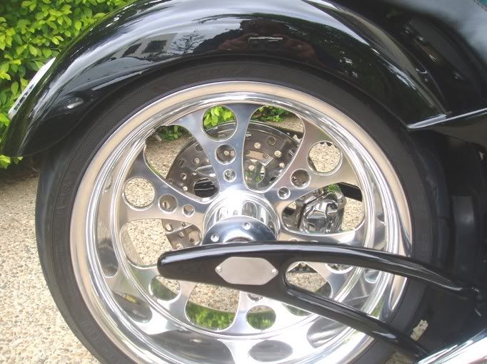

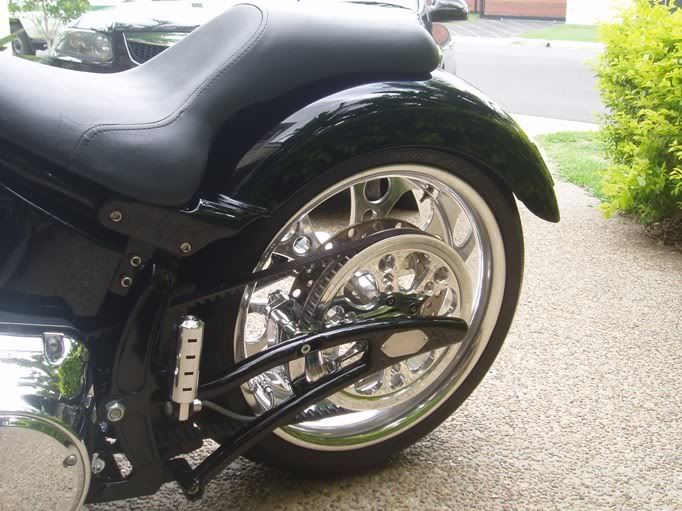

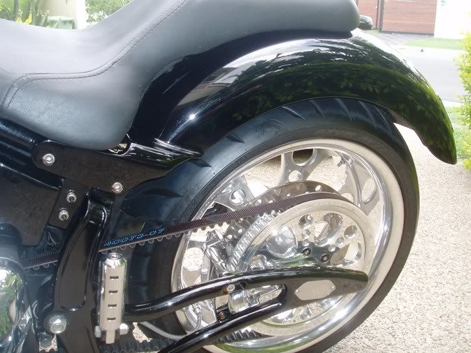

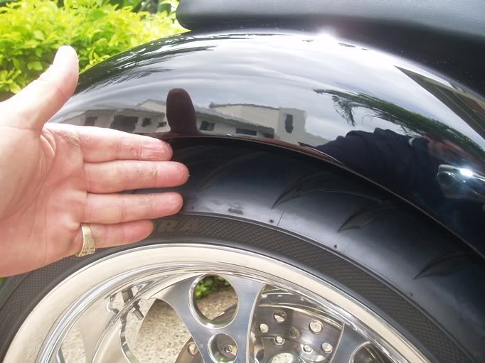

  • grpawalky
    grpawalky
     Well the Shotgun Shocks arrived last Wednesday. Fitted on Friday. Man what a ride now. I love the ability to adjust the rebound (from soft to firm). I can get it down nice and low, tuckin rim and then adjust the ride quality. They are also ideal when I carry a pillion, just pump it up a tad and off we go. Mounted the switches out of sight under the coil cover, no ones any the wiser.
    I'll try and post some pics. The best mod I've done so far!!
  • FAT TONY
    FAT TONY
    looks great Matt
    sweeeeeeeeeet ride
    A head light ring would finish it off just nicely
  • fatasspaul
    fatasspaul
    Great job there Matt, hope you enjoy it.
    Looks great dumped
