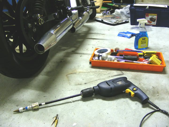

    Even though I've only had the bike for less than a week now I've done a fair few tweaks to it thus far. In the last 24 hours this has included new grips and - more importantly - the drilling of the plugs in the stock exhaust baffles.
    Now, if there's anyone on here who still has stock pipes on their Sporty - YOU MUST DO THIS MOD!
    Really, the difference in sound is night and day, and for such a quick and easy mod you'll be amazed.
    I found the stock exhaust to be extremely quiet, especially when cruising on part throttle which made the Iron sound like a mixmaster. After the simple addition of a 12mm hole in the end plugs of each exhaust baffle the exhaust note changes to a deep burble both on and off throttle. Its raspier and meatier, and as a first time Harley owner I'm actually very happy to have the sound I thought the bike should have had from ther showroom.

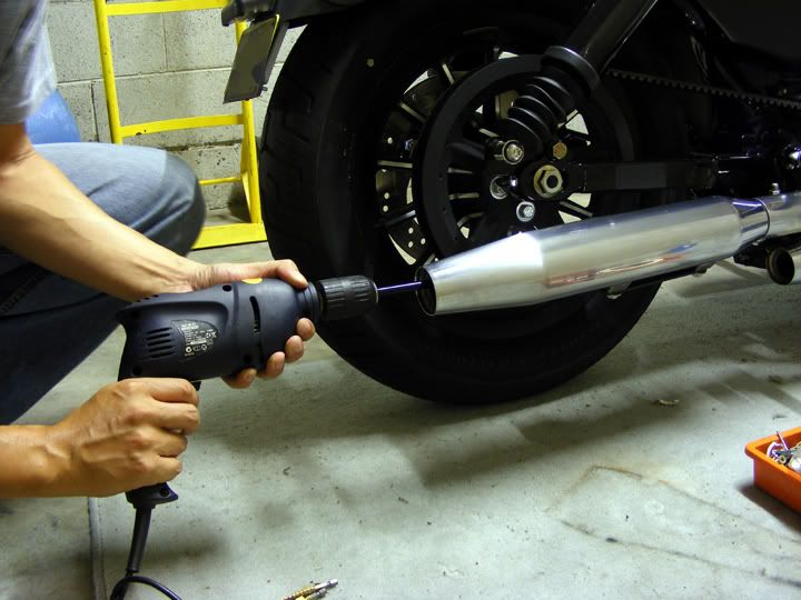

    For the uninitiated, essentially this mod entails drilling a single 12 - 18mm hole the the small 30mm diameter end bungs that you can see if you shine a torch into the stock mufflers. The steel is very thin and easy to drill through, while some others have taken to knocking these bungs out completely. This, alegedly, will result in a whilsting sound at idle, so I decided to start with 12mm holes and so how it went from there.

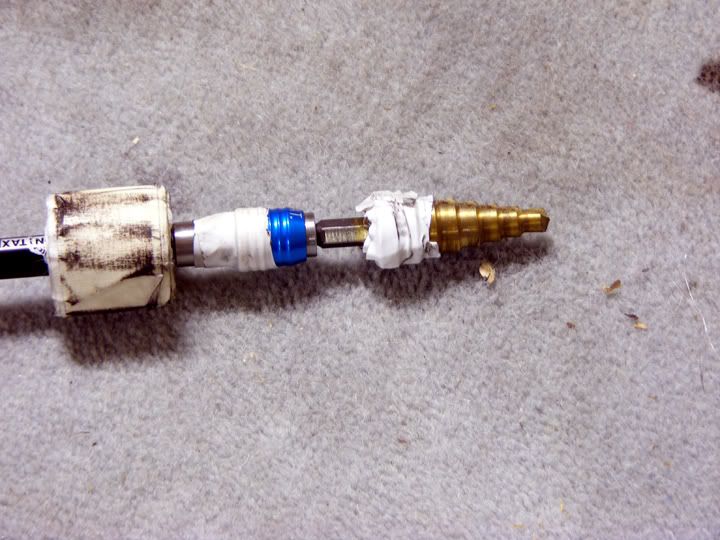

    The biungs ar about 25cm into each muffler. To drill them I went to Bunning and bought an extension for my 240V drill as well as a set of step up drill bits as shown in the pictures. I wrapped the shaft of the drill extension with masking tape to create a 30mm ring that would centre the drill in the exhaust. I also taped the drill bit at the 12mm marker so that I would know when I'd reach this diameter hole.
    Honestly, it is an incredibly easy and satisfying mod if you can't afford to buy new pipes. After all, the Screamin Eagle pipes are silly money in Oz when most of us just want to S-O-U-N-D!

    The learning is that, if like me you buy the Sontax 3 piece step drill set from Bunnings (with quick change shank), you must use the 6-20mm bit and tape it at the 12mm step. If you use the 3-12mm or 4-12mm bit you risk losing the bit inside the muffler.
