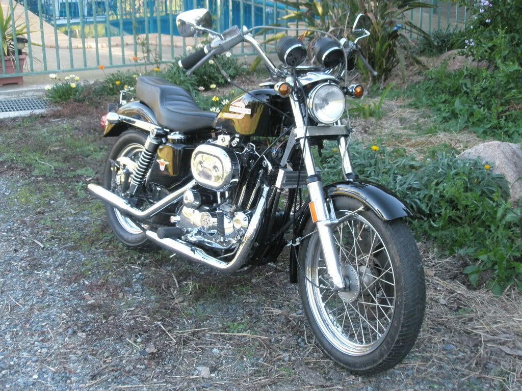

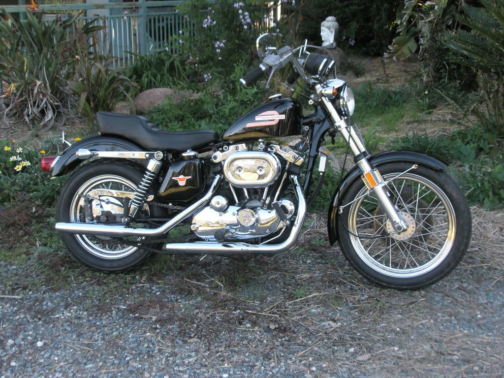

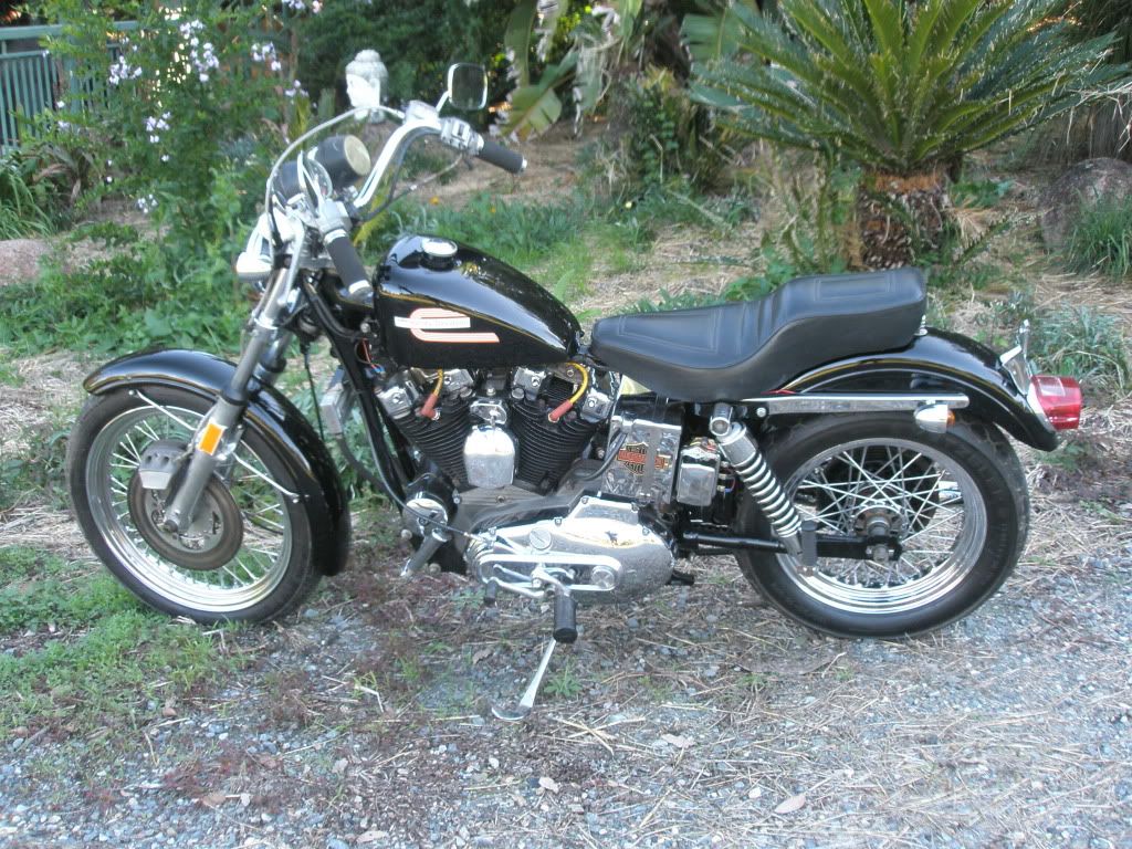

  • matt
    matt
    Hi, here's a couple of pics of the new addition. Goes great and is a pleasure to ride. Only minor details to fix up to bring it back to original. Very happy!
    Matt ,,, Orsom Bike,,,,, I love these Old Classic, I think I need one
  • monarofan
    monarofan
    Matt, looks like a top score, well done, and looks like electric start ta boot
  • Choco
    Choco
    Top looking bike Matt hope you have years of fun with it.
  • kickinon
    kickinon
    that is a good lookin bike, very neat,,,
    looks cared for,, & thats a hell of a front brake line,,,,,
  • shaggz
    shaggz
    Wicked lookin sporty ya got there matt
  • The Don
    The Don
    Mate of mine had one of those Matt, it taught him a lot about Harleys (good and bad),
    it's a nice example, keep it as stock as possible if you can, they are getting scarce in original trim.
  • matt
    matt
    Thanks for all the positive replies! The plan is to restore it to as original as possible and ride it as much as I can!
