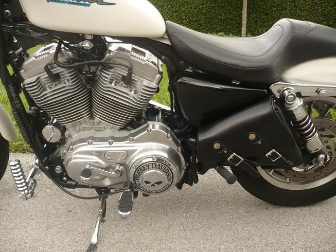

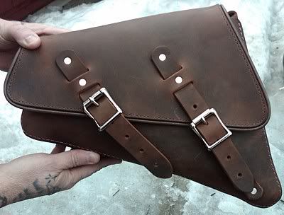

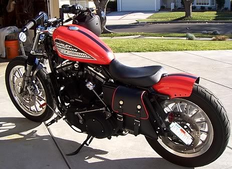

     Does anyone know of a solo bag available in Australia like this Licks bag? They are about USD 200 in the US, so expensive by the time you get it here. And does anyone know how they are held on? Must be some sort of elastic strapping.

    The rear of the bag has slots in it. The bag comes with a leather strap that goes around the frame and two velcro straps that go around fender strut near the shock mount and then around the swing arm. No problems with the left side; having to do some re-adjustment on the right side to keep it off the exhaust and out of the way of the shocks; am using zip ties on the right as it is fiddlier to get at the correct height. The various straps will scuff the frame a little... nothing that won't polish out at this point. You may have to extend your pillion pegs if you use them.
