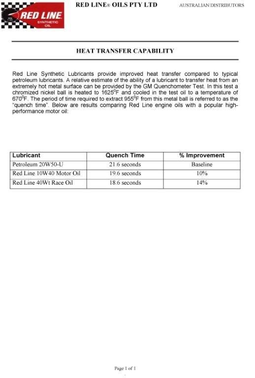

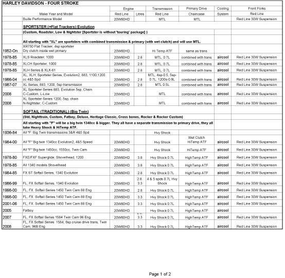

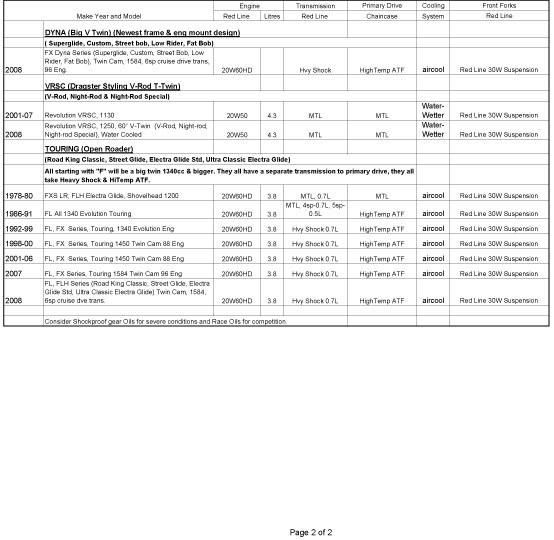

    Decided to drop a line to Redline in Australia and received this reply.................. together with attachments which I have converted to jpeg. Hope they are readable.....................
    Question: I am using Redline ATF in my primary on a 2007 Dyna Street Bob (Harley), whereas I note many other people are using MTL!!! Are you able to tell me the difference? One thought I have is that ATF might aerate more. Look forward to your comments.
    Answer: Red Line High Temp ATF is our recommended fluid in the primary drive of a 2008 Dyna Street Bob. I have attached a recommendation guide and you can see that we really only call for MTL in the primary in the V-rods although you could say the XL Series Sportsters also use it, as their primary is combined with their transmission which does use MTL.
    You don't want an oil that foams (aerates) as this puts air bubbles into the oil that are incapable of keeping metal to metal apart and hinder the oil's ability to transfer heat. All of Red Line oils have the highest heat transfer capability - see attachment. If you have used an oil in the past that "aerates" in your bike - I recommend you don't use it again as it indicates a lack of decent anti-foaming chemistry and will result in the bike running hot.
    In answer to your question about the difference between MTL and our ATFs - here is a brief description. Many manufacturers call for ATFs in manual transmission applications because it allows a smoother gear shift which is what the customer wants to see. The downside and what you can't see is that ATFs don't contain the protection that a specific manual tranmission oil contains in order to keep metal to metal gearteeth apart. So the manufacturer chooses between poor gearshift but gearteeth protection OR good gearshift and no gearteeth protection (which most customers won't know about- at least until out of warranty period when the gearbox may need rebuilding).
    In the case of Red Line there is a special advantage using our ATFs where the manufacturer calls for it under warranty. Common ATFs only have a rating equivelant of a GL2. (Dont worry about what this means). Red Line ATFs have a rating of GL4 which is the same rating as what gear oil manufacturers make their specific manual transmission oils to be. This means that Red Line ATFs give a significantly higher protection when used in manual transmissions because the manufacturer demands ATF for warranty servicing. In some situations, if you are out of warranty concerns, you could upgrade to Red Line MTL. This is a GL4 manual transmission oil (also has hydraulic capbilites) that gives specific gearteeth protection and has a light flow similar to ATF fluids.
    Hope this hasn't proved too confusing. As a word of advise, don't trust what you read on forums in regards to what others may or may not be using. I have come across 16 year oil kids having great pleasure messing about in technical forums, using appropriate terms which makes them sound authentic and they don't even have a license! I have attached our current recommendation guide - feel free to email this onto to any other Harley mates so they get the correct recommendations.
