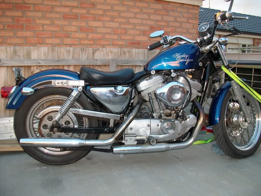

    This is it ,Bought it home today

    Cleaned up that would be a thing of beauty as is....I do see the appeal of Cafe racers though

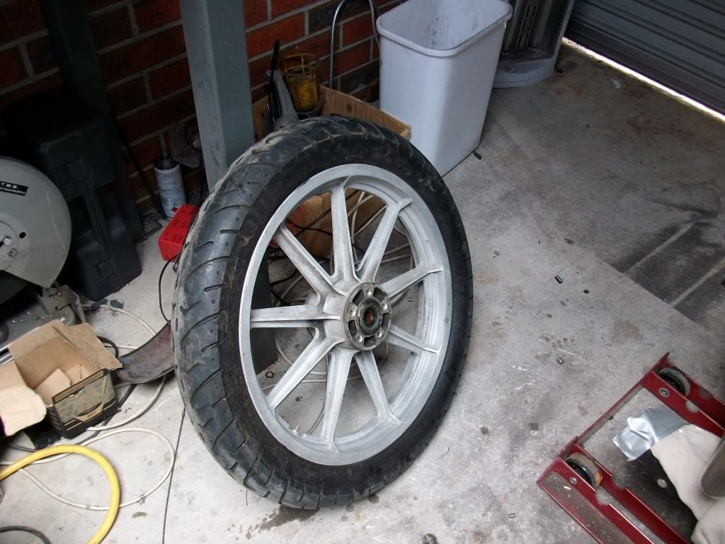

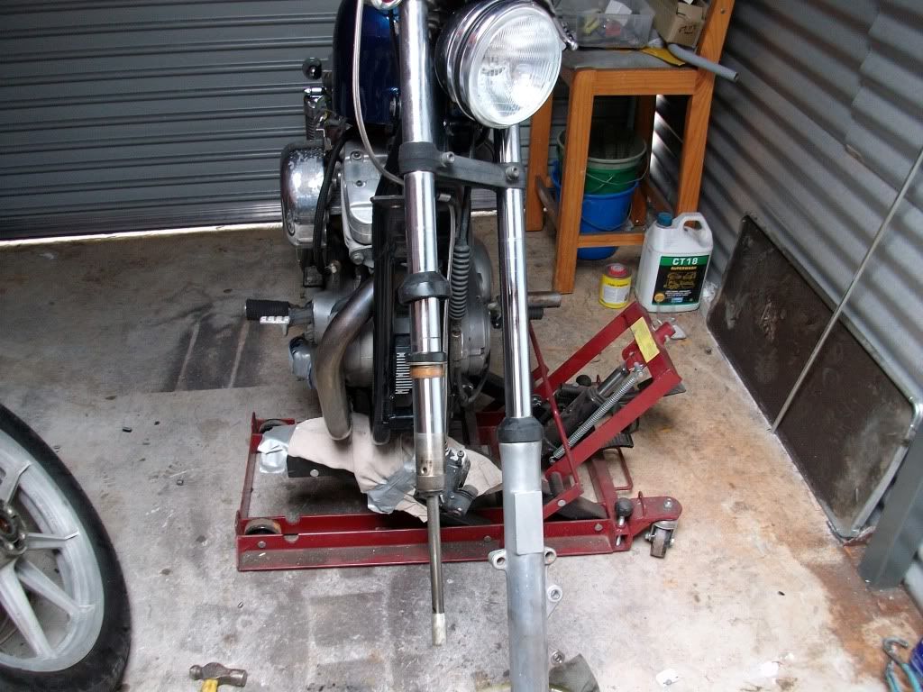

    I had the old Alloy Wheels left over from the 79 that was the doner for my Bobber, So the plan is to use them on this one. The Front End on the 79 is a Twin Disc, Perfect for this Bike

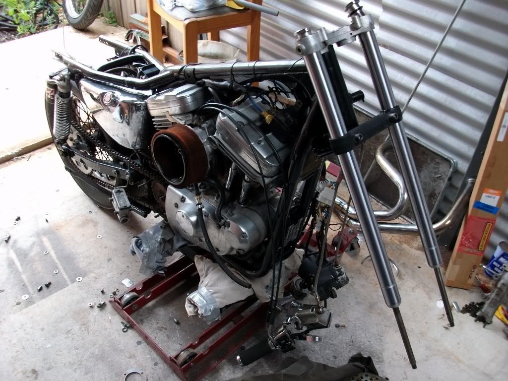

    Both Bikes have a 35mm Front End, The Tubes on on the 79 are pitted, I thought I could just use the Twin Disc Sliders and fit them on to the 86 Tubes.
    But no they have diffrent Ends on the bottom of the Tubes and diffrent Seals, I will have to track down some new Tubes tommorrow .
    The Wheel will fit up with out any problems. I will get them Powder Coated in the next week or so

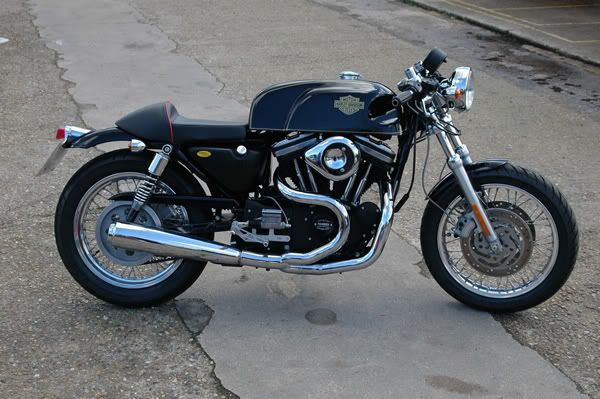

    For those that dont know what a Cafe Racer is . There not every one's cup of tea,

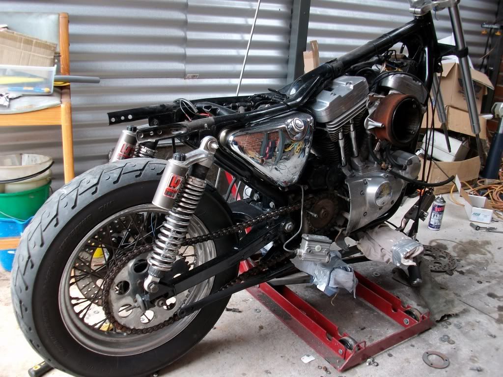

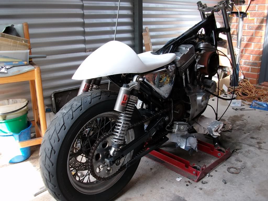

    I had a little free time to work on the Bike today.. Striped off the old Bars and Headlight and a few unwanted bits, fitted the New Fork Tubes. Fitted the Shocks. and tryed out the Tail.

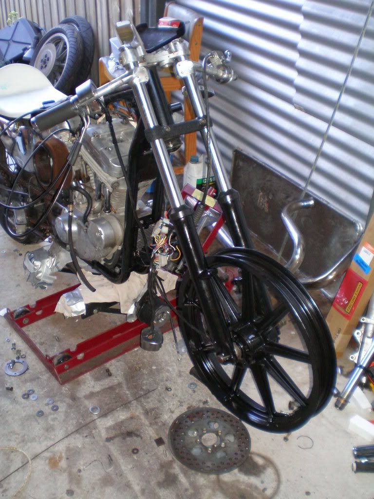

    I got back from the Pub run last night so I had a litle free time late this arvo. I got some of the Parts back from the Powder Coaters so I had to try them out
