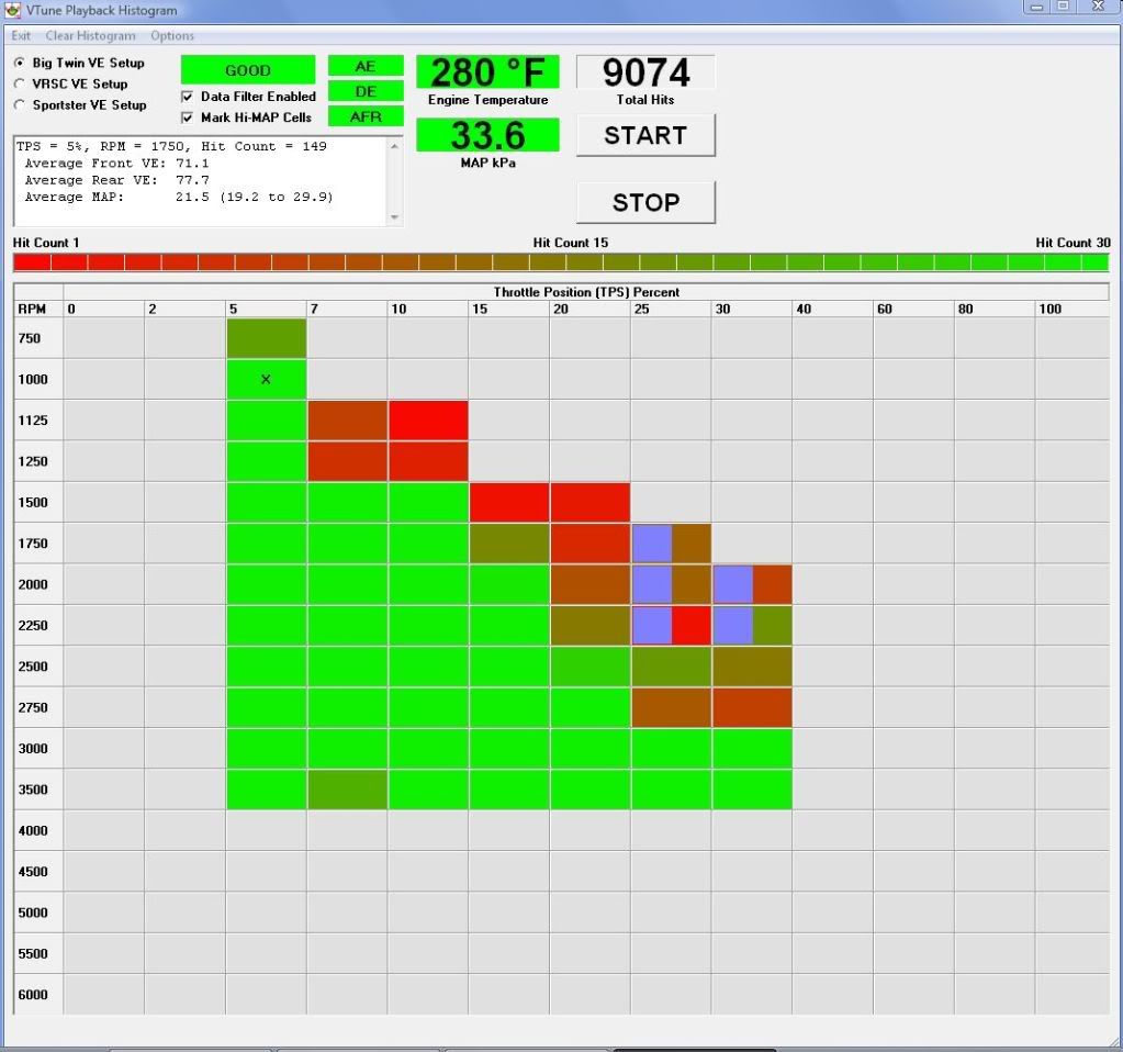

    I did some Vtuning on Friday and this is the final histogram. I thought there would have been recordings in the 0 and 2% areas at about the 1000 rpm level, or am I wrong in thinking this??

    DBW bikes use the throttle to control idle so it is very rare to see anything in the 0 and 2% areas. The update is still being worked on so its not out until later this week.
