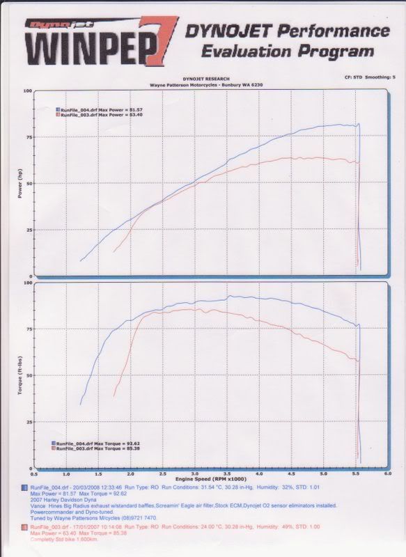

    went down to Bunbury today... 340Km round trip to have the bike mapped... best money spent and well worth the trip. Just wish I had done it last Sept when I fitted the pipes, PCIII and breather. Bike runs much better, very little popping etc. Now to see what fuel economy is.
    One comment from Wayne... don't run BP 98.... clogs up exhause etc... stated that SW Harley have been complaining that some addatives in 98 cause big problems and best to use 95.. I'll ask SW Harley when I'm down there in a couple of weeks putting a deposit on an upgrade
    When I ran it on dyno a few months back it was 74hp.... new figures are:

    18 RWHP is a nice gain, but that torque curve looks nice and flat. You must really notice the difference when you open her up.
    not been down south with speed demons since the dyno, and only run was double demerits so took it easy. Have notice difference in performance, with less popping and it would also appear better fuel consumption... will post more info after the 5th/6th
