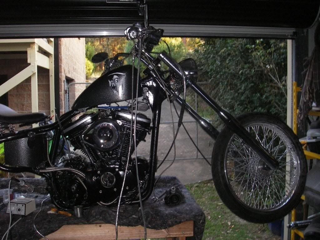

    Just thought i'd put a photo up here of my current build. Still got a bit to go but its getting there.
    Post some more Photos,,,, This looks very interesting

    Here's a few more pictures. Hope no one was expecting to see a restoration.
    This is where it all began.
    After the first rebuild (still not satisfied though)
    This time around I thought I'd try something different, very different.
    On the way back or black
    Bugger I should have realised when you stretch a bike the wiring won't reach
    Just about to come down off the bench.
    Is that Hammer tone ? Love it
  • muzza15
    muzza15
    No it's not hammer tone paint. Its my own combination. It's black base coat then matte clear with platinum flakes in it. It's different but I'm happy with it.

    nice swing arm , did you make it??.cheers..dc..
  • muzza15
    muzza15
    It's the original one stretched and widend with the original gussets put back in place.

    Heres the basic specs of this bike at this stage.
    XLH1100 Evo
    V2 Andrews Cams
    Andrews pushrods
    S & S e type carb
    Andrews gears kit
    300x35x18  rear (80 spoke)
    21 front (80 Spoke)
    Swingarm (owner modified)
    DNA w/glide front end
    Springer headlight
    farward controls (wildrider)
    Softale oil tank (owner modified)
    Ultima seat (sprung solo)
    Hagon lower progressive shocks
    Rake including 6 deg' over trees 45 deg overall
    Frame widend and stretched
    Theres a lot more but this is all I can think of at the moment. Hope you find it interesting its been a lot of fun so far.
