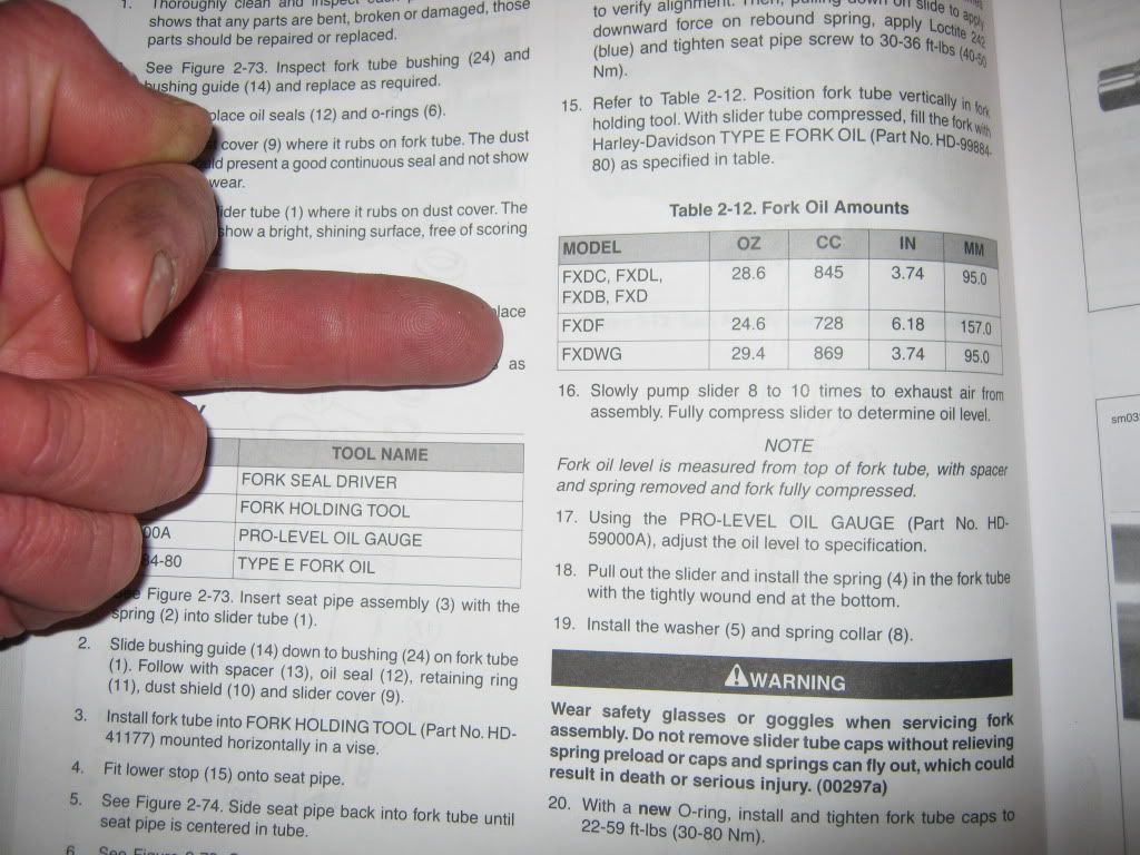

    Hi, just after a little help re fork oil on my 2009 Fat Bob. I have just put progressive 812's on the rear and stock length progressive springs on the front. Not much of a mechanic but had ago myself anyway. My confusion is in regard to the spring oil level. When i took the old springs out the oil level was about 300mm down the tubes from the top but the progressive instruction was that it should be about 140. At 140 the oil just overflows when trying to push the spacer down and screw in the cap. I had about 3/4 - 1" of supplied spacer sticking out the top of the tube so it was a bit of an effort to screw the cap back in. Anyway I settled for oil level at about 160 from top without spring in tube, then put it all back together. Just can't help but feeling that I have probably got this wrong and would really appreciate any solid advice. I put in 10w oil and I weight about 90kgs. set the rear shocks 1 up from softest setting ( I think)

    Thanks Hilly, maybe I can't see for looking but I cannot locate the quantity in the book that came with the bike. I guess it is not a proper service manual. Do you have any idea what level is supposed to be in a 2009 Fat Bob? Thanks a heap.
  • Alfun
    Alfun
    Hilly, do you mean compress the fork or make sure it is extended all the way out? At the moment I am about 160 down from the top of the tubes where the cap screws into. It all seems pretty strange, with the progressive instruction sheet recommending a maximum of 140mm to the oil level from the top of the tube but the existing level which I measured following removal of the springs and spacers was something like 300mm from the top.
  • Alfun
    Alfun
    Thanks Hilly, your a champ. I'm at the sunshine coast at the moment ( daughter had 1st baby, yeh I'm old!) but will stuck straight back into it when home. I must be dumb, just couldn't connect the dots.... did not think to compress the forks and measure!

    All the 08 Dynas (apart from the wide glide) are as follows:
    page 2.55 in manual
    level is 110mm from top
    26.6 oz (787cc) per Fork
    Type "E" oil - HD-99884-80
    So you might want to check what the 09 manual says.

    The recommended oil is 5W (FORK OIL not a petroleum based oil which disintegrates over time as changes occur in its molecular structure in your rubber parts) which is the equivalent of the HD type (Type "E" oil - HD-99884-80).  When you use thicker oil than your metering is than different to what the engineers who designed this piece of equipment.  You are going to have a bit of a problem figuring out the sag due to the progressively wound springs you are using.  My job is suspension.  You may change the metering holes by welding and re-drilling or use the inexpensive Race Tech Cartridge emulators where you can change by a screw driver and a 5/16" wrench.  The compression is adjusted by the oil height as is the last bit of the stroke prior to bottom out.  Raise the oil level and the result is increased resistance  as the forks moves through the last part of the stroke.  This is known as increasing your air spring.  Each line is representing 10 mm increase.  The shock dyno is used on a single 30 mm Öhlins cartridge mounted inside of a fork.  This is for a visual example only.  This is used inside of one of my Fat Bob forks.  There you have it.
