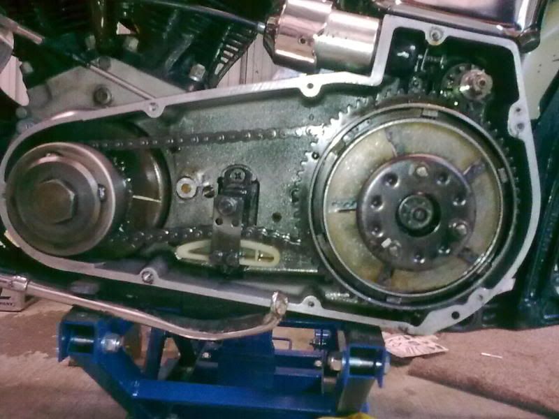

    ok have a look at these and tell me your thoughts.......
  • DynaRider
    DynaRider
    I really cannot tell much from the pics, except that chain deflection does seem to be getting up there(but that is hard to determine exactly from the pics)
    in the bottom pic there appears to be a kink in the chain near the ring gear, which ia a bad thing if that is what I am really seeing, again, hard to tell from a pic
    so.........
    I take it removing the compensator is a problem?
    do the chain rollers appear worn?
    I am very happy to see a three finger clutch though, as they work the best(in my opinion, the only ones that work)
    do you rely upon the breather for oil feed?
  • seaeagle
    seaeagle
    the second pic is when i first got it 6-7mths ago, i replaced the comp.spring
    sprockets are all good.
    ive done 2500miles on it now and its showing....lol
    the top pic is with the adjuster shoe swaped around to the top bolts, there is a bigger curve and more pressure on the shoe and it will wear quick, im aware of that, im just hoping having the adjuster that way it will work for a bit longer

    yes, I realised the progression of things
    are you checking carefully for a tight spot when you set the adjustment?
  • DynaRider
    DynaRider
    well, you need to check the chain in a few different places, as it may be tighter in one area of the chain than another
    which would not be at all uncommon with a well used chain
    so if you set the adjustment when the chain happened to be in a loose area, it would be too tight elsewhere
    this would put great pressure on things like your inner primary bearing, LH main bearing, and the chain itself

    and to be fair, your adjuster is looking a little to the right of centre there
