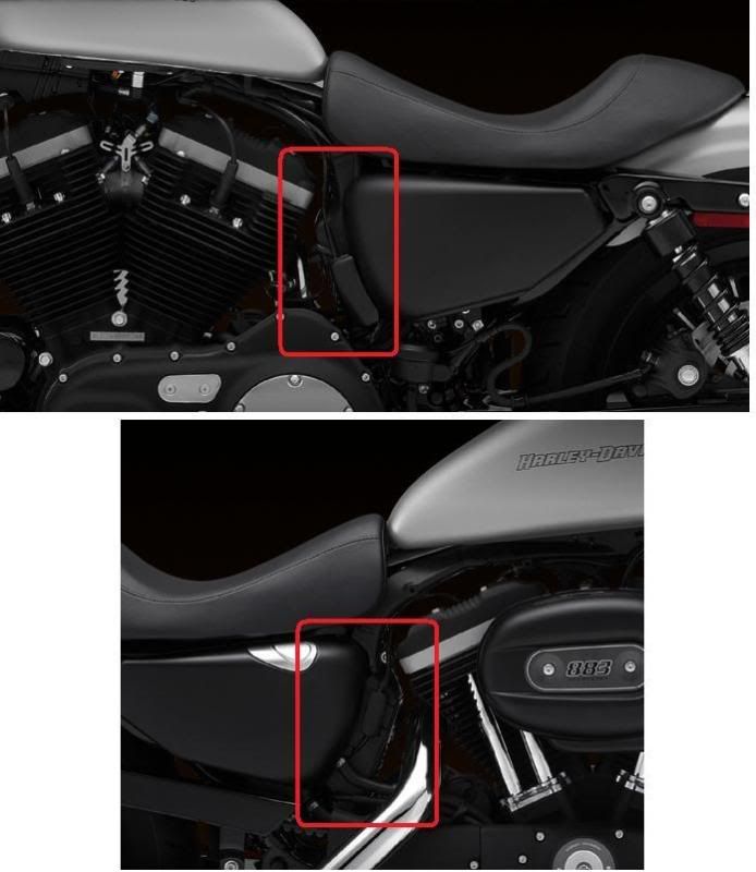

    I think HD have moved the ECM on the 2010 sporty's between the frame and the rear cylinder, in an effort to make some room under the seat for a new sprung seat.
    I have no idea if they have moved the ECM on other models, or even if the above info is correct? Scotty, let us know if this true.
    But if you could move it to this position it might be better

    thats wear P/STEV put my power comander ,on that down tube 07 bob,  i cookt 2 of them and then changed to the T/MAX , its now not behind the rear cyd
