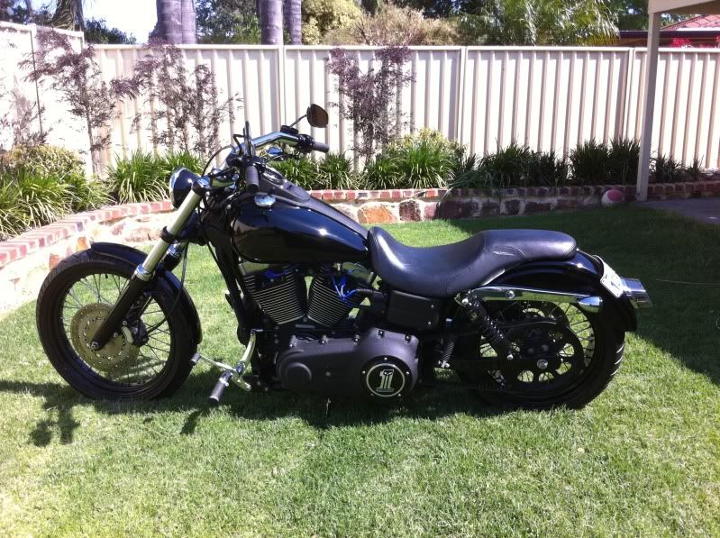

    Any others out there that have strectched or done a wide arse conversion to their Dyna. The bike pictured was an 03 FXD Superglide. These photos are a couple of years old and taken when I was living In Melbourne. The bike was fully engineered in Victoria but I have since moved to Cairns QLD rode the bike until VIC rego ran out and I have not got around to engineering it in Queensland yet. So I am using the drivetrain for my 70 shovel frame project. Once I finish mockup, I will put it back on the road again.
    Mods are:
    Frame raked to 36 Degrees,  +3 Degrees in trees for Total 39 Degrees Rake
    4" over aftermarket wideglide front end with dyna 19" Front wheel
    4" added to Backbone
    I hade the frame mods done by Bob Martin M/Cycle Engineering to simplify the engineering approval ( told me this was the first Dyna they ever Stretched)
    250 Avon on 18x8.5 60 Spoke Rim
    Zodiac 45mm primary offset kit
    8" pullback V bars
    I enjoy cutting and grinding so I built the following:
    Swingarm using the rails from a factory Dyna swingam.
    Stretched tank is a combination of Cut up FXD tank and aftermarket tank. 26L capacity

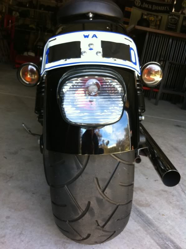

    Rear Guard is a 3" widened FXD unit.
    You shouldn't have get the Bike Re Engeneered just because you moved States

    I love that front guard! where can I get one?

    I got the neck of mine cut and raked and put 200 on rear it's 06 streetbob.
    Should've just bought a wideglide but dance with the bitch you brung.
  • Dingo
    Dingo
    Did it myself mate. 5.75" rim laced to a stock hub which is offset 10mm. Guard is stock. Not much clearance ther.

    Shit so you got the 200 in a stock guard!? good effort, I heard it'll only fit up to 180!
