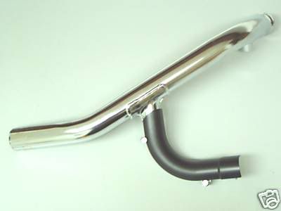

    i have an fxdc 08 it has an exhaust valve
    i have read people remove/disable these, is this adr emmission crap?
    what effect does this have on power / torque and noise? i have a plain non valved pipe not fitted
    i have screamin computer -----------if i fit this pipe will i need a re map?.

    seems its to pass an adr rolling noise test at around 3000rpm it opens
    not on us/jap models
    just restricts exhaust flow at low speed / rpm
