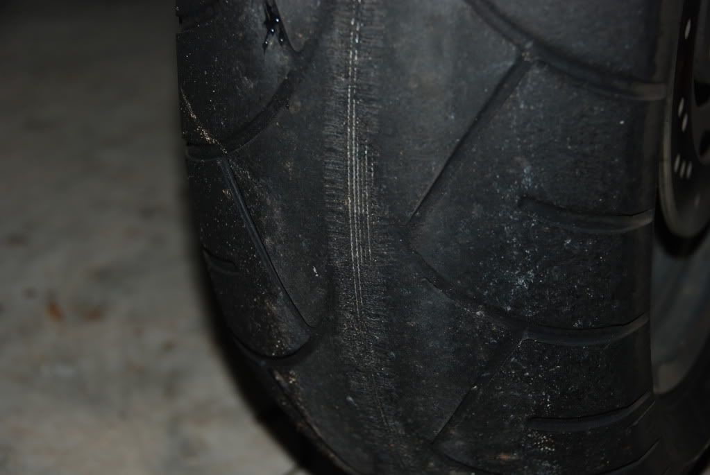

    Noticed this the other day
    Rear tyre has a gouge half the diameter of the tyre, about 10mm wide and down to the steel belt. About 2000km old.
    Anyone seen this before?
     and no!!! no burn outs on this one (yet)

    Yeah, but...... I don't believe this is wear related.
    This is either
    • A strip has let go (tyre fault) or..........
    • I've bottomed out and something under the guard, like a protruding bolt has done the damage. I can't remember bottoming out. In fact I would say it's impossible as I'm only a little fella and I can't see any protruding bolts or.........
    • When I 'locked it up' (that was a surprise, broad siding down the road) on a wet road in Darwin a couple of weeks ago, this may have done the damage. May have caught a stone or the like
    There is still ~4mm meat on both sides of the gouge
    I'm more inclined to think it was the lock up that did it due to the chatter marks on either side of the gouge
    Was just asking if this damage is a common thing

    I rekon it's probably waaay out of balance .Or maybe just a dud tyre, iether way it's most definiatly Fucked !
  • speedzter
    speedzter
    The tyre is basically bald in the middle !
    Sorry to say it looks like tyre wear to me.
    What compound and load rating is the tyre ? Have you run this type of tyre before ?

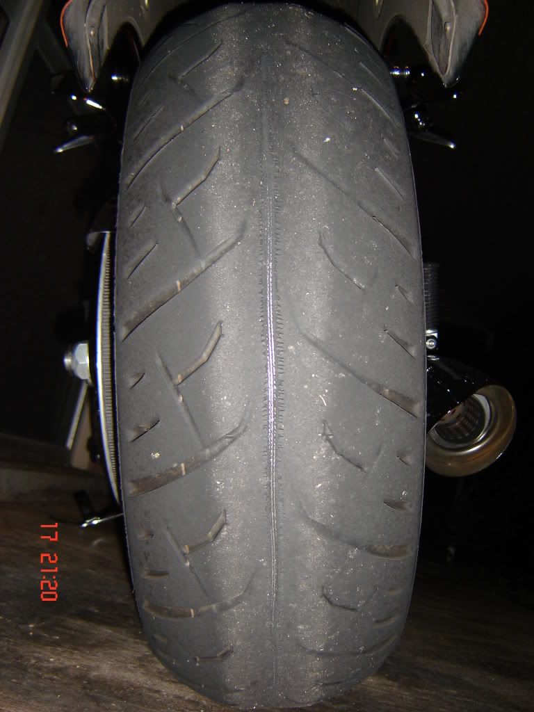

    Well here's mine after this weekend....... Done 4650km......
    Metzler 880.....too soft for the softy...... going back to Dunlops D407

    that tyre will do 8000ks its tyre pressure that causes it to wear like that, keep it bang on 38psi with the next one and see the difference. the front tyre will wear on the right cos of road camber, it will wear the back of the tread off before the front of the groove
