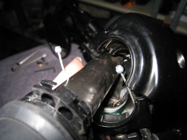

    5) On to the right side.  The right side was reasonably straight forwad also just followed the instructions and found no surprised with it.

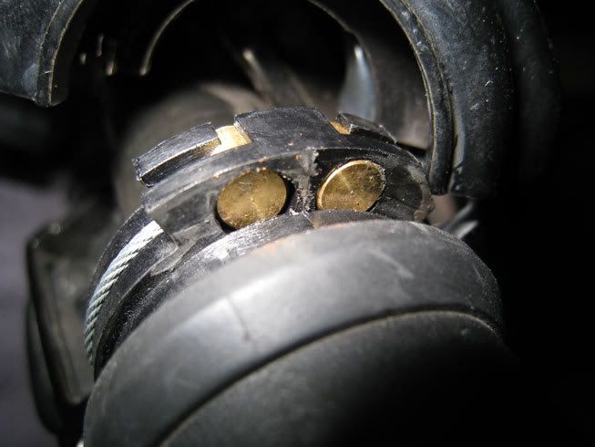

    - First step was to loosen the right side switch housing screws so that the housing seperates enough to slide the grip out.  Some caution is required here not to lose the brass stoppers which are on the ends of the throttle and idle cables.
    - Then loosen both the throttle and idle cable lock nuts.  It's recommended to mark their positions with a texter before you loosen the lock nuts for easy re-location after
    6) I found the cables once loosened were quite easy to get onto the new grip.  I didn't even need to use pliers.

    1. The right-hand stock grip is over the throttle tube and the tube contains the notches on the two cables. So then does the grip need to house these cables, or do you just glue up on to the tube. I expected some sort of lip to go under the housing, with its own notches...

    Not sure about the aftermarket grips... but the stock right-hand grip itself at the base has a channel for the throttle cable and notches to house the brass ferrules. I put on HD Aeliron grips which had the same channel and notches built into the base end of the grip that when fitted sits under the handlebar clamp.
    KC has a pic above with the ferrules out... but this one might help give the idea too of what is under the housing and what is moulded onto the end of the right-hand grip.
    This one shows the grip once you remove the ferrules and throttle so that you can see the moulding on the end of the grip. It's not on a separate throttle sleeve.

    It took me around an hour and a half. First problem was on the throttle side I started with and the second brass ferrel I was reattaching decided to scoot and fell into the bottom of the housing. Not easy to get back up. I taped over the cableto the housing to prevent this again (which I am spruiking as a fine trick).
