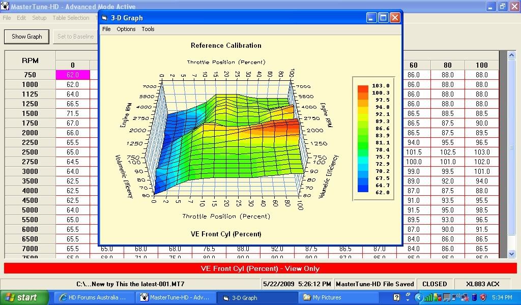

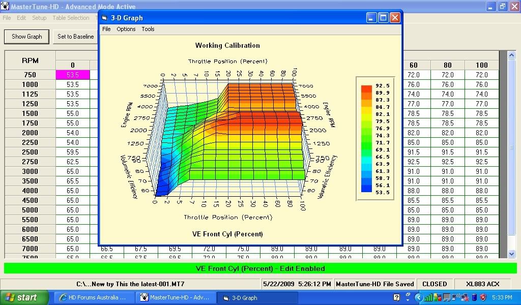

    Scotty or Oz is this normal in the VE tables from the original TTS upload file to the run files. The first image is the original file the XD171-002 the second image is my latest VE run do i need more VE runs?

    Scotty:
    Yes, I see that relationship.  And I have been blending as you said with the last number in the particular row.
    Even though that last entry on the right might not be in the 80-85kPa range, I'm still using it for final blending.
    Have completed 3 good VTunes, and even though I haven't filled all the cells that might be possible, I've got some great hits in the areas I normally ride in.

  • Steve Cole
    Steve Cole
    Sounds to me you guys are getting a good handle on it down under. It nice to see some people really beginning to use the tools as they were intended to be used.
