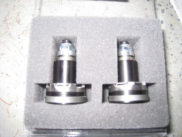

    The ingredients:
    Intiminators arrived!!!

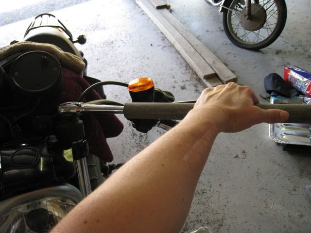

    Getting the fork caps off:

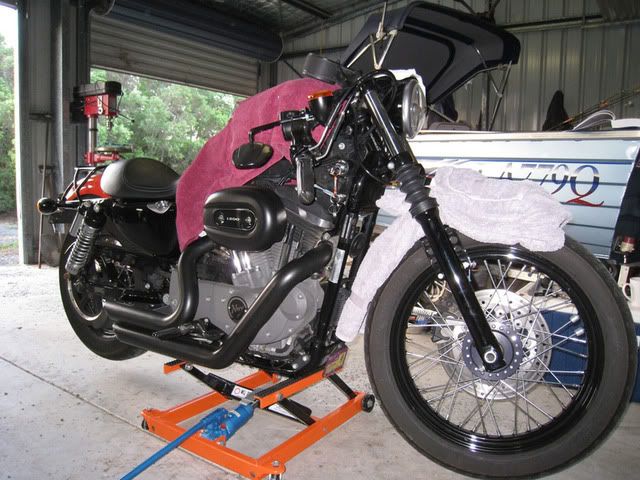

    Loosening the caps required some extra leverage. Did this before putting Nyx up on her lift.

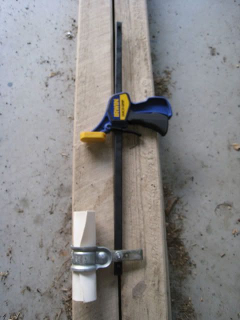

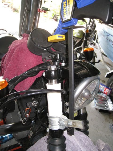

    I made a fork cap compressing clamp.
    I used that above the socket and driver to stop the "flyoff" that occurs when you finally run out of thread and the springs uncompress driving the cap airbourne

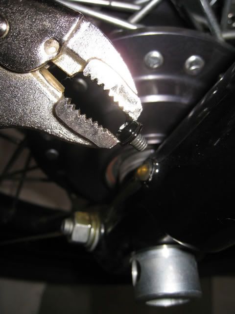

    Getting the drain screw out:
    I thought all was going smoothly: I had my bars off, got the caps off with no airbourne missiles, and had the springs out. Whew... I was doing well, pat on the back Then the installation started going south. I stripped that "sweet" little fork drain screw. Yes I was using a #2 Phillips head... and I even lightly tapped the driver with a rubber mallet, but that soft little screw still stripped just so delightfully.
    Though the same softness that had me strip the little bugger worked in my favour when gripping it with locking pliers to get it out.
    So the forks drained while I went into town and got replacement screws.

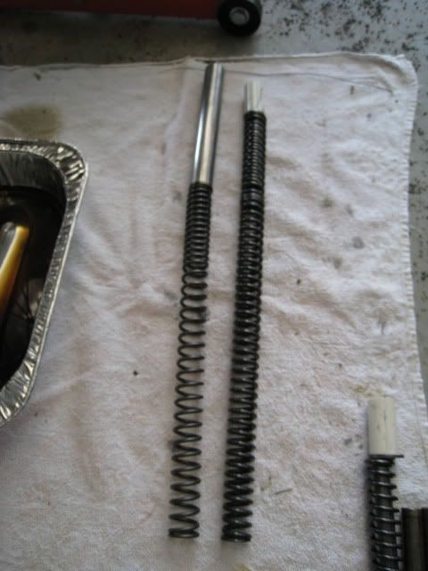

    The springs:
    This is a pic of a comparison between the stock 08 1200N fork spring (#47299-07) and preload (#48737-07) pictured on the left and the Works dual rate fork spring with the 2" of preload that I had been using on the right.
    I then trimmed the preload spacers by half an inch back to 1.5" in length to compensate for the added height of the intiminator.

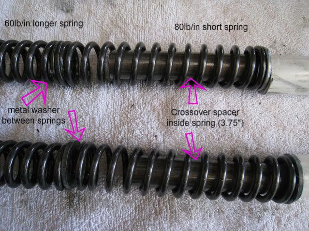

    Putting it all back together with the new drain screws in place and 364ml (12.3oz) of the 5w fork oil the order was:
    • intiminators in first,
    • the long 60lb/in works spring,
    • a metal washer,
    • the short 80lb/in works spring,
    • the 3.75" metal crossover spacer then slides inside of this shorter top spring,
    • a metal washer on top of that,
    • then the 1.5" pvc preload spacer,
    • before replacing the fork cap.
    The pic below shows the Works Dual Rate springs in the configuration I use them in. From right to left... the 1.5" pvc preload spacer. You can then see the 3.75" metal spacer inside the shorter 80lb/in spring, the metal washer and the top part of the 60lb/in longer spring which continues out of picture.

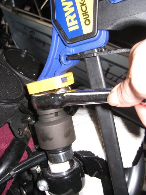

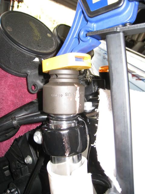

    Getting the fork caps back on:
    I marked on the fork cap, the socket and the triple tree where the threads would start to take. I then compressed the socket and fork cap. It took a few goes to get it to depress squarely into the tube, then just turned the socket till the caps "took".

    I was thinking for a minute gee Glen has a very feminine forearm.
