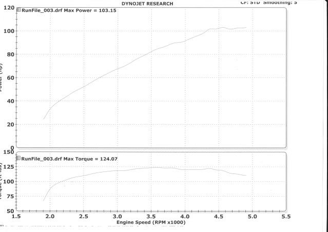

    This isn't meant to be a pissing contest.It is just the only dyno chart that is for a similar cubic inch to mine.
    Hope the photo comes up as it shows a good comparison between the 2.
    This is my 116 S&S with 625 cams, twin 42 HSR Mikuni carbs&,Daytona Twin-Tec ignition.
    The boys at Startline Racing,Moss St Slacks Creek told me that only 2 bikes have ever been brought to them that they haven't had to touch.
    Mine is the second one.
    Still running stock headers & S/E slip ons so I can see bigger numbers happening once we build a new set of pipes for it.
    Realistically though,numbers don't mean as much as the power delivery curve.

    if ya took the V&H straight shots off and put a decent 2 into 1 on it you prolly go to mid 120s.

    Yeah FYO its a 2001 Wide Glide.
    I've actually wound the pumps on the carbs back further than recommended by Mikuni as it was dumping too much fuel in too early.
    But pretty sure the settings they were talking about was for a single carby.
    I'll probably bring the pump arm 1/2 mm closer now & see how that goes.
    Not that I'll put it back on the dyno,I was only checking AFR to make sure I hadn't tuned it too lean.

    Just got off the phone to my mate Pills (spleen vent) that built this motor for me.
    He agrees that once I dial the pumpers in a bit better that torque line should raise up a bit more.
    Probably around 130?
    As we discussed,both lines start to drop just before 4000 rpm.so a little bit more at 3500 would suit well.

    yup is a strong and good engine i built this one a whiles ago an first off run a over sized 42 mikuni on it shit loads of downlow an up high but could do with bit more playin around .i have the theory with carbs bigger aint nessacarilly better with the correct air flow an fuel ya can get big nubbers proved it on a mates 110 with a 42 .
    issues bike run pretty good with the twin mikunis butttttt the rwhp would jump a fair bit an so would toque if he ran a single carb but the revs would go up to 4500rpm an gettin the tourque an hp is great as he dont need to flog it an rev it far to get the power ect them pipes are goin an im makin some newys in next few weeks eein he has left bike here for me to play some more
