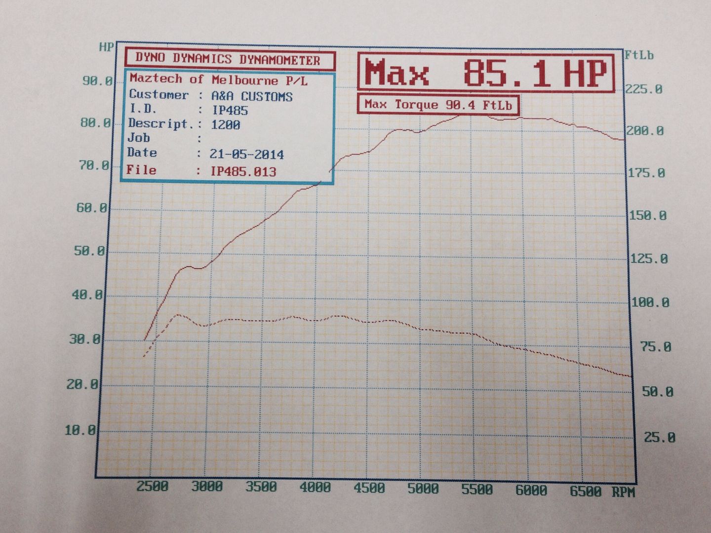

    I did a hammer 1250 kit (just barrels and pistons) not too long ago. I prefer using their stuff, they make good products and have great customer service. The bike i did was an 883 iron and buy just doing the barrels and pistons the bike made great power, but this isnt just because of the upgrade, the correct tune has a lot to do with it, from what i see a lot of guys out there tune efi like its a carby and end up with the same results....not many bikes getting around with these results....

    There are plenty of guys out there spending a few more grand to get 10-15hp more over their rpm range, when all some of them needed to do was find the right person to tune it for a few hundred more dollars.....there are tunes and there are tunes.....
    My 883 is a testament to that, i use stock untouched heads, barrels, pistons, cams, crank, rods, gearing and ran 13.0@103mph (a world record according to the US guys.)
